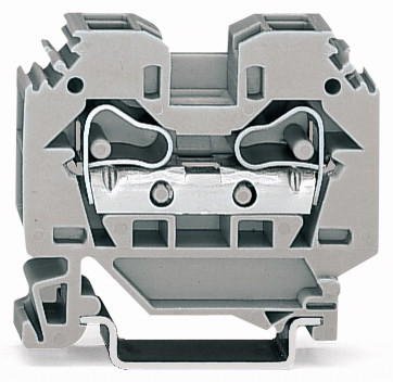

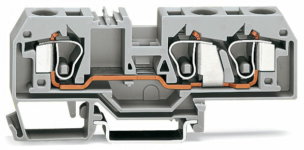

Parameters / Models | 284-101![]() | 284-104![]() | 284-107![]() | 284-301![]() | 284-302![]() | 284-308![]() | 284-309![]() | 284-316![]() | 284-317![]() | 284-318![]() | 284-322![]() | 284-325![]() | 284-326![]() | 284-327![]() | 284-328![]() | 284-329![]() | 284-330![]() | 284-331![]() | 284-332![]() | 284-333![]() | 284-334![]() | 284-335![]() | 284-336![]() | 284-337![]() | 284-338![]() | 284-339![]() | 284-340![]() | 284-341![]() | 284-342![]() | 284-343![]() | 284-344![]() | 284-345![]() | 284-346![]() | 284-357![]() | 284-358![]() | 284-367![]() | 284-368![]() | 284-400![]() | 284-402![]() | 284-405![]() | 284-409![]() | 284-412![]() | 284-413![]() | 284-414![]() | 284-415![]() | 284-422![]() | 284-601![]() | 284-604![]() | 284-607![]() | 284-607/999-950![]() | 284-621![]() | 284-624![]() | 284-681![]() | 284-682![]() | 284-684![]() | 284-687![]() | 284-687/999-950![]() | 284-691![]() | 284-901![]() | 284-902![]() | 284-904![]() | 284-907![]() | 284-907/999-950![]() | 284-992![]() | 284-993![]() |
Actuation type | Operating tool | Operating tool | Operating tool | Operating tool | Operating tool | Operating tool | Operating tool | Operating tool | Operating tool | Operating tool | Operating tool | Operating tool | Operating tool | Operating tool | Operating tool | Operating tool | Operating tool | Operating tool | Operating tool | Operating tool | Operating tool | Operating tool | |||||||||||||||||||||||||||||||||||||||||||
Цвет | gray | blue | green-yellow | gray | orange | gray | gray | gray | orange | light gray | orange | gray | gray | orange | orange | orange | light gray | light gray | gray | gray | gray | gray | gray | gray | light gray | orange | orange | light gray | light gray | orange | orange | orange | orange | gray | gray | orange | orange | yellow | gray | yellow | gray | gray | gray | gray | yellow | yellow-green | gray | blue | green-yellow | green-yellow | gray | blue | gray | orange | blue | green-yellow | green-yellow | light gray | gray | orange | blue | green-yellow | green-yellow | light gray | light gray |
Connectable conductor materials | Copper | Copper | Copper | Copper | Copper | Copper | Copper | Copper | Copper | Copper | Copper | Copper | Copper | Copper | Copper | Copper | Copper | Copper | Copper | Copper | Copper | Copper | |||||||||||||||||||||||||||||||||||||||||||
Connection technology | CAGE CLAMP® | CAGE CLAMP® | CAGE CLAMP® | CAGE CLAMP® | CAGE CLAMP® | CAGE CLAMP® | CAGE CLAMP® | CAGE CLAMP® | CAGE CLAMP® | CAGE CLAMP® | CAGE CLAMP® | CAGE CLAMP® | CAGE CLAMP® | CAGE CLAMP® | CAGE CLAMP® | CAGE CLAMP® | CAGE CLAMP® | CAGE CLAMP® | CAGE CLAMP® | CAGE CLAMP® | CAGE CLAMP® | CAGE CLAMP® | |||||||||||||||||||||||||||||||||||||||||||
Connection technology 2 | Screw clamp connection | Screw clamp connection | |||||||||||||||||||||||||||||||||||||||||||||||||||||||||||||||
Country of origin | DE | DE | DE | CN | CN | CN | DE | CN | CN | CN | CN | CN | DE | CN | CN | DE | CN | DE | CN | DE | CN | CN | CN | CN | CN | CN | DE | CN | DE | DE | CN | CN | CN | DE | DE | DE | DE | DE | DE | DE | DE | IN | DE | DE | DE | DE | DE | DE | DE | DE | IN | IN | DE | DE | DE | DE | DE | DE | DE | DE | DE | DE | DE | DE | DE |
Габариты: глубина | 52 mm / 2.047 inch | 52 mm / 2.047 inch | 52 mm / 2.047 inch | 52 mm / 2.047 inch | 52 mm / 2.047 inch | 97.4 mm / 3.835 inch | 96.5 mm / 3.799 inch | 69 mm / 2.717 inch | 69 mm / 2.717 inch | 69 mm / 2.717 inch | 62 mm / 2.441 inch | 77.5 mm / 3.051 inch | 76.6 mm / 3.016 inch | 69 mm / 2.717 inch | 77.5 mm / 3.051 inch | 76.6 mm / 3.016 inch | 77.5 mm / 3.051 inch | 76.6 mm / 3.016 inch | 62 mm / 2.441 inch | 52 mm / 2.047 inch | 68 mm / 2.677 inch | 79 mm / 3.11 inch | 81 mm / 3.189 inch | 69 mm / 2.717 inch | 69 mm / 2.717 inch | 97.4 mm / 3.835 inch | 96.5 mm / 3.799 inch | 97.4 mm / 3.835 inch | 96.5 mm / 3.799 inch | 52 mm / 2.047 inch | 68 mm / 2.677 inch | 79 mm / 3.11 inch | 81 mm / 3.189 inch | 77.5 mm / 3.051 inch | 97.4 mm / 3.835 inch | 77.5 mm / 3.051 inch | 97.4 mm / 3.835 inch | 9 mm / 0.354 inch | 9 mm / 0.354 inch | 9 mm / 0.354 inch | 9 mm / 0.354 inch | 9 mm / 0.354 inch | 69 mm / 2.717 inch | 69 mm / 2.717 inch | 69 mm / 2.717 inch | 69 mm / 2.717 inch | 89 mm / 3.504 inch | 89 mm / 3.504 inch | 97.5 mm / 3.839 inch | 97.5 mm / 3.839 inch | 97.5 mm / 3.839 inch | 97.5 mm / 3.839 inch | 97.5 mm / 3.839 inch | 69 mm / 2.717 inch | 78 mm / 3.071 inch | 78 mm / 3.071 inch | 78 mm / 3.071 inch | 78 mm / 3.071 inch | 78 mm / 3.071 inch | 78 mm / 3.071 inch | 97.5 mm / 3.839 inch | ||||
Design | horizontal | horizontal | horizontal | horizontal | horizontal | horizontal | horizontal | horizontal | horizontal | horizontal | horizontal | horizontal | horizontal | horizontal | horizontal | horizontal | horizontal | horizontal | horizontal | horizontal | horizontal | horizontal | |||||||||||||||||||||||||||||||||||||||||||
Fine-stranded conductor | 0.2 … 10 mm² / 24 … 8 AWG | 0.2 … 10 mm² / 24 … 8 AWG | 0.2 … 10 mm² / 24 … 8 AWG | 0.2 … 10 mm² / 24 … 8 AWG | 0.2 … 10 mm² / 24 … 8 AWG | 0.2 … 10 mm² / 24 … 8 AWG | 0.2 … 10 mm² / 24 … 8 AWG | 0.2 … 10 mm² / 24 … 8 AWG | 0.2 … 10 mm² / 24 … 8 AWG | 0.2 … 10 mm² / 24 … 8 AWG | 0.2 … 10 mm² / 24 … 8 AWG | 0.2 … 10 mm² / 24 … 8 AWG | 0.2 … 10 mm² / 24 … 8 AWG | 0.2 … 10 mm² / 24 … 8 AWG | 0.2 … 10 mm² / 24 … 8 AWG | 0.2 … 10 mm² / 24 … 8 AWG | 0.2 … 10 mm² / 24 … 8 AWG | 0.2 … 10 mm² / 24 … 8 AWG | 0.2 … 10 mm² / 24 … 8 AWG | 0.2 … 10 mm² / 24 … 8 AWG | 0.2 … 10 mm² / 24 … 8 AWG | 0.2 … 10 mm² / 24 … 8 AWG | |||||||||||||||||||||||||||||||||||||||||||
Fine-stranded conductor (2) | 6 … 35 mm² / 10 … 2 AWG | 6 … 35 mm² / 10 … 2 AWG | |||||||||||||||||||||||||||||||||||||||||||||||||||||||||||||||
Fire load, MJ | 0.29 | 0.291 | 0.095 | 0.092 | 0.161 | 0.139 | 0.091 | 0.089 | 0.089 | 0.119 | 0.132 | 0.115 | 0.086 | 0.131 | 0.114 | 0.137 | 0.116 | 0.123 | 0.04 | 0.049 | 0.056 | 0.059 | 0.087 | 0.087 | 0.161 | 0.141 | 0.163 | 0.141 | 0.04 | 0.049 | 0.056 | 0.058 | 0.064 | 0.064 | 0.063 | 0.08 | 0.004 | 0.02 | 0.048 | 0.033 | 0.05 | 0.017 | 0.013 | 0.021 | 0.019 | 0.253 | 0.261 | 0.243 | 0.32 | 0.435 | 0.443 | 0.443 | 0.409 | 0.409 | 0.261 | 0.348 | 0.348 | 0.348 | 0.327 | 0.327 | 0.348 | 0.438 | |||
GTIN | 4044918323383 | 4044918323413 | 4045454084585 | 4017332286725 | 4017332286732 | 4017332291590 | 4017332291606 | 4017332286756 | 4017332286763 | 4017332199407 | 4017332286794 | 4017332291613 | 4017332291620 | 4017332286800 | 4017332291637 | 4017332291644 | 4017332291651 | 4017332580090 | 4017332286817 | 4017332286824 | 4017332286831 | 4017332286848 | 4017332252003 | 4017332286855 | 4017332199414 | 4017332291675 | 4017332291682 | 4017332296120 | 4017332291699 | 4017332195928 | 4017332195935 | 4017332195942 | 4017332337342 | 4017332337014 | 4017332337199 | 4017332337182 | 4017332337205 | 4017332286862 | 4044918396363 | 4017332286886 | 4044918255394 | 4045454074524 | 4044918255455 | 4044918255615 | 4017332155748 | 4044918396387 | 4044918486361 | 4044918486422 | 4045454084592 | 4045454084615 | 4045454282561 | 4045454282578 | 4044918447379 | 4044918447454 | 4044918447485 | 4045454084639 | 4045454091569 | 4044918486484 | 4044918305730 | 4044918305754 | 4044918305778 | 4045454084646 | 4045454091910 | 4044918305815 | 4044918447508 |
Height | 40 mm / 1.575 inch | 40 mm / 1.575 inch | 35 mm / 1.378 inch | 33.7 mm / 1.327 inch | 33.5 mm / 1.319 inch | 33.5 mm / 1.319 inch | 33.5 mm / 1.319 inch | 40 mm / 1.575 inch | 35 mm / 1.378 inch | 33.7 mm / 1.327 inch | 31.3 mm / 1.232 inch | 35 mm / 1.378 inch | 33.7 mm / 1.327 inch | 35 mm / 1.378 inch | 33.7 mm / 1.327 inch | 40 mm / 1.575 inch | 23 mm / 0.906 inch | 26.5 mm / 1.043 inch | 26.5 mm / 1.043 inch | 26.5 mm / 1.043 inch | 31.3 mm / 1.232 inch | 31.3 mm / 1.232 inch | 35 mm / 1.378 inch | 33.7 mm / 1.327 inch | 35 mm / 1.378 inch | 33.7 mm / 1.327 inch | 23 mm / 0.906 inch | 26.5 mm / 1.043 inch | 26.5 mm / 1.043 inch | 26.5 mm / 1.043 inch | |||||||||||||||||||||||||||||||||||
Height from upper-edge of DIN-35 rail | 41.5 mm / 1.634 inch | 41.5 mm / 1.634 inch | 41.5 mm / 1.634 inch | 33.5 mm / 1.319 inch | 33.5 mm / 1.319 inch | 33.5 mm / 1.319 inch | 33.5 mm / 1.319 inch | 39.5 mm / 1.555 inch | 39.5 mm / 1.555 inch | 35 mm / 1.378 inch | 35 mm / 1.378 inch | 35 mm / 1.378 inch | 35 mm / 1.378 inch | 35 mm / 1.378 inch | 33.5 mm / 1.319 inch | 35 mm / 1.378 inch | 35 mm / 1.378 inch | 35 mm / 1.378 inch | 35 mm / 1.378 inch | 35 mm / 1.378 inch | 35 mm / 1.378 inch | 35 mm / 1.378 inch | |||||||||||||||||||||||||||||||||||||||||||
Insulating material | Polyamide 66 (PA 66) | Polyamide 66 (PA 66) | Polyamide 66 (PA 66) | Polyamide 66 (PA 66) | Polyamide 66 (PA 66) | Polyamide 66 (PA 66) | Polyamide 66 (PA 66) | Polyamide 66 (PA 66) | Polyamide 66 (PA 66) | Polyamide 66 (PA 66) | Polyamide 66 (PA 66) | Polyamide 66 (PA 66) | Polyamide 66 (PA 66) | Polyamide 66 (PA 66) | Polyamide 66 (PA 66) | Polyamide 66 (PA 66) | Polyamide 66 (PA 66) | Polyamide 66 (PA 66) | Polyamide 66 (PA 66) | Polyamide 66 (PA 66) | Polyamide 66 (PA 66) | Polyamide 66 (PA 66) | |||||||||||||||||||||||||||||||||||||||||||
Legend (ratings) | (III / 3) ≙ Overvoltage category III / Pollution degree 3 | (III / 3) ≙ Overvoltage category III / Pollution degree 3 | (III / 3) ≙ Overvoltage category III / Pollution degree 3 | (III / 3) ≙ Overvoltage category III / Pollution degree 3 | (III / 3) ≙ Overvoltage category III / Pollution degree 3 | (III / 3) ≙ Overvoltage category III / Pollution degree 3 | (III / 3) ≙ Overvoltage category III / Pollution degree 3 | (III / 3) ≙ Overvoltage category III / Pollution degree 3 | (III / 3) ≙ Overvoltage category III / Pollution degree 3 | (III / 3) ≙ Overvoltage category III / Pollution degree 3 | (III / 3) ≙ Overvoltage category III / Pollution degree 3 | (III / 3) ≙ Overvoltage category III / Pollution degree 3 | |||||||||||||||||||||||||||||||||||||||||||||||||||||
Marking level | Side marking | Side marking | Side marking | Side marking | Side marking | Side marking | Side marking | Side marking | Side marking | Center marking | Center marking | Center marking | Center marking | Center marking | Side marking | Center marking | Center marking | Center marking | Center marking | Center marking | Center marking | Center marking | |||||||||||||||||||||||||||||||||||||||||||
Number of connection points | 1 | 1 | |||||||||||||||||||||||||||||||||||||||||||||||||||||||||||||||
Number of connection points (connection type) | 3 | 3 | |||||||||||||||||||||||||||||||||||||||||||||||||||||||||||||||
Number of levels | 1 | 1 | 1 | 1 | 1 | 1 | 1 | 1 | 1 | 1 | 1 | 1 | 1 | 1 | 1 | 1 | 1 | 1 | 1 | 1 | 1 | 1 | |||||||||||||||||||||||||||||||||||||||||||
Product Group | 1 (Rail Mounted Terminal Blocks) | 1 (Rail Mounted Terminal Blocks) | 1 (Rail Mounted Terminal Blocks) | 1 (Rail Mounted Terminal Blocks) | 1 (Rail Mounted Terminal Blocks) | 1 (Rail Mounted Terminal Blocks) | 1 (Rail Mounted Terminal Blocks) | 1 (Rail Mounted Terminal Blocks) | 1 (Rail Mounted Terminal Blocks) | 1 (Rail Mounted Terminal Blocks) | 1 (Rail Mounted Terminal Blocks) | 1 (Rail Mounted Terminal Blocks) | 1 (Rail Mounted Terminal Blocks) | 1 (Rail Mounted Terminal Blocks) | 1 (Rail Mounted Terminal Blocks) | 1 (Rail Mounted Terminal Blocks) | 1 (Rail Mounted Terminal Blocks) | 1 (Rail Mounted Terminal Blocks) | 1 (Rail Mounted Terminal Blocks) | 1 (Rail Mounted Terminal Blocks) | 1 (Rail Mounted Terminal Blocks) | 1 (Rail Mounted Terminal Blocks) | 1 (Rail Mounted Terminal Blocks) | 1 (Rail Mounted Terminal Blocks) | 1 (Rail Mounted Terminal Blocks) | 1 (Rail Mounted Terminal Blocks) | 1 (Rail Mounted Terminal Blocks) | 1 (Rail Mounted Terminal Blocks) | 1 (Rail Mounted Terminal Blocks) | 1 (Rail Mounted Terminal Blocks) | 1 (Rail Mounted Terminal Blocks) | 1 (Rail Mounted Terminal Blocks) | 1 (Rail Mounted Terminal Blocks) | 1 (Rail Mounted Terminal Blocks) | 1 (Rail Mounted Terminal Blocks) | 1 (Rail Mounted Terminal Blocks) | 1 (Rail Mounted Terminal Blocks) | 1 (Rail Mounted Terminal Blocks) | 1 (Rail Mounted Terminal Blocks) | 1 (Rail Mounted Terminal Blocks) | 1 (Rail Mounted Terminal Blocks) | 1 (Rail Mounted Terminal Blocks) | 1 (Rail Mounted Terminal Blocks) | 1 (Rail Mounted Terminal Blocks) | 1 (Rail Mounted Terminal Blocks) | 1 (Rail Mounted Terminal Blocks) | 1 (Rail Mounted Terminal Blocks) | 1 (Rail Mounted Terminal Blocks) | 1 (Rail Mounted Terminal Blocks) | 1 (Rail Mounted Terminal Blocks) | 1 (Rail Mounted Terminal Blocks) | 1 (Rail Mounted Terminal Blocks) | 1 (Rail Mounted Terminal Blocks) | 1 (Rail Mounted Terminal Blocks) | 1 (Rail Mounted Terminal Blocks) | ||||||||||
Rated current, A | 57 | 57 | 125 | 30 | 15 | 57 | 57 | 125 | 125 | 57 | 57 | 57 | 57 | 57 | 57 | ||||||||||||||||||||||||||||||||||||||||||||||||||
Rated current (Ex e II), A | 53 | 53 | 53 | ||||||||||||||||||||||||||||||||||||||||||||||||||||||||||||||
Rated impulse voltage (III / 3), kV | 8 | 8 | 8 | 8 | 8 | 8 | 8 | 8 | 8 | 8 | 8 | 8 | |||||||||||||||||||||||||||||||||||||||||||||||||||||
Rated voltage (III / 3), В | 800 | 800 | 800 | 800 | 800 | 800 | 800 | 800 | 800 | 800 | 800 | 800 | |||||||||||||||||||||||||||||||||||||||||||||||||||||
Rated voltage EN (Ex e II), В | 550 | 550 | 550 | ||||||||||||||||||||||||||||||||||||||||||||||||||||||||||||||
Solid conductor | 0.2 … 10 mm² / 24 … 8 AWG | 0.2 … 10 mm² / 24 … 8 AWG | 0.2 … 10 mm² / 24 … 8 AWG | 0.2 … 10 mm² / 24 … 8 AWG | 0.2 … 10 mm² / 24 … 8 AWG | 0.2 … 10 mm² / 24 … 8 AWG | 0.2 … 10 mm² / 24 … 8 AWG | 0.2 … 10 mm² / 24 … 8 AWG | 0.2 … 10 mm² / 24 … 8 AWG | 0.2 … 10 mm² / 24 … 8 AWG | 0.2 … 10 mm² / 24 … 8 AWG | 0.2 … 10 mm² / 24 … 8 AWG | 0.2 … 10 mm² / 24 … 8 AWG | 0.2 … 10 mm² / 24 … 8 AWG | 0.2 … 10 mm² / 24 … 8 AWG | 0.2 … 10 mm² / 24 … 8 AWG | 0.2 … 10 mm² / 24 … 8 AWG | 0.2 … 10 mm² / 24 … 8 AWG | 0.2 … 10 mm² / 24 … 8 AWG | 0.2 … 10 mm² / 24 … 8 AWG | 0.2 … 10 mm² / 24 … 8 AWG | 0.2 … 10 mm² / 24 … 8 AWG | |||||||||||||||||||||||||||||||||||||||||||
Solid conductor (2) | 6 … 35 mm² / 10 … 2 AWG | 6 … 35 mm² / 10 … 2 AWG | |||||||||||||||||||||||||||||||||||||||||||||||||||||||||||||||
Strip length | 12 … 13 mm / 0.47 … 0.51 Inch | 12 … 13 mm / 0.47 … 0.51 Inch | 12 … 13 mm / 0.47 … 0.51 Inch | 12 … 13 mm / 0.47 … 0.51 Inch | 12 … 13 mm / 0.47 … 0.51 Inch | 12 … 13 mm / 0.47 … 0.51 Inch | 12 … 13 mm / 0.47 … 0.51 Inch | 12 … 14 mm / 0.47 … 0.55 Inch | 12 … 14 mm / 0.47 … 0.55 Inch | 12 … 13 mm / 0.47 … 0.51 Inch | 12 … 13 mm / 0.47 … 0.51 Inch | 12 … 13 mm / 0.47 … 0.51 Inch | 12 … 13 mm / 0.47 … 0.51 Inch | 12 … 13 mm / 0.47 … 0.51 Inch | 12 … 13 mm / 0.47 … 0.51 Inch | 12 … 13 mm / 0.47 … 0.51 Inch | 12 … 13 mm / 0.47 … 0.51 Inch | 12 … 13 mm / 0.47 … 0.51 Inch | 12 … 13 mm / 0.47 … 0.51 Inch | 12 … 13 mm / 0.47 … 0.51 Inch | 12 … 13 mm / 0.47 … 0.51 Inch | 12 … 13 mm / 0.47 … 0.51 Inch | |||||||||||||||||||||||||||||||||||||||||||
Total number of connection points | 2 | 2 | 2 | 2 | 2 | 2 | 2 | 4 | 4 | 3 | 3 | 3 | 3 | 3 | 2 | 2 | 2 | 2 | 2 | 2 | 2 | 3 | |||||||||||||||||||||||||||||||||||||||||||
Total number of potentials | 1 | 1 | 1 | 1 | 1 | 1 | 1 | 1 | 1 | 1 | 1 | 1 | 1 | 1 | 1 | 1 | 1 | 1 | 1 | 1 | 1 | 1 | |||||||||||||||||||||||||||||||||||||||||||
Type of mounting | DIN-35 rail | DIN-35 rail | DIN-35 rail | DIN-35 rail | DIN-35 rail | DIN-35 rail | DIN-35 rail | DIN-35 rail | DIN-35 rail | DIN-35 rail | DIN-35 rail | DIN-35 rail | DIN-35 rail | DIN-35 rail | DIN-35 rail | DIN-35 rail | DIN-35 rail | DIN-35 rail | DIN-35 rail | DIN-35 rail | DIN-35 rail | DIN-35 rail | |||||||||||||||||||||||||||||||||||||||||||
Type of wiring | Side-entry wiring | Side-entry wiring | Side-entry wiring | Front-entry wiring | Front-entry wiring | Front-entry wiring | Front-entry wiring | Front-/Side-entry wiring | Front-/Side-entry wiring | Front-entry wiring | Front-entry wiring | Front-entry wiring | Front-entry wiring | Front-entry wiring | Front-entry wiring | Front-entry wiring | Front-entry wiring | Front-entry wiring | Front-entry wiring | Front-entry wiring | Front-entry wiring | Front-entry wiring | |||||||||||||||||||||||||||||||||||||||||||
Вес, г | 18.072 | 18.157 | 27.115 | 3.17 | 3.08 | 5.38 | 4.7 | 3.04 | 2.97 | 2.981 | 3.96 | 4.41 | 3.83 | 2.87 | 4.36 | 3.81 | 4.55 | 3.85 | 4.09 | 1.413 | 1.62 | 1.85 | 1.98 | 2.91 | 2.9 | 5.35 | 4.69 | 5.43 | 4.71 | 1.34 | 1.62 | 1.85 | 1.94 | 2.14 | 2.14 | 2.11 | 2.8 | 0.125 | 3.81 | 1.38 | 5.1 | 13.65 | 2.78 | 2.078 | 0.75 | 3.87 | 18.889 | 18.83 | 27.353 | 29.213 | 55.5 | 55.6 | 31.99 | 31.89 | 31.93 | 40.044 | 40.044 | 18.721 | 23.1 | 23.23 | 23.206 | 31.58 | 31.58 | 23.206 | 31.829 |
Ширина | 10 mm / 0.394 inch | 10 mm / 0.394 inch | 10 mm / 0.394 inch | 2.5 mm / 0.098 inch | 2.5 mm / 0.098 inch | 2.5 mm / 0.098 inch | 2 mm / 0.079 inch | 2.5 mm / 0.098 inch | 2.5 mm / 0.098 inch | 2.5 mm / 0.098 inch | 2 mm / 0.079 inch | 2.5 mm / 0.098 inch | 2 mm / 0.079 inch | 2 mm / 0.079 inch | 2.5 mm / 0.098 inch | 2 mm / 0.079 inch | 2.5 mm / 0.098 inch | 2 mm / 0.079 inch | 2 mm / 0.079 inch | 1 mm / 0.039 inch | 1 mm / 0.039 inch | 1 mm / 0.039 inch | 1 mm / 0.039 inch | 2 mm / 0.079 inch | 2 mm / 0.079 inch | 2.5 mm / 0.098 inch | 2 mm / 0.079 inch | 2.5 mm / 0.098 inch | 2 mm / 0.079 inch | 1 mm / 0.039 inch | 1 mm / 0.039 inch | 1 mm / 0.039 inch | 1 mm / 0.039 inch | 1 mm / 0.039 inch | 1 mm / 0.039 inch | 1 mm / 0.039 inch | 1 mm / 0.039 inch | 10 mm / 0.394 inch | 20 mm / 0.787 inch | 7 mm / 0.276 inch | 6 mm / 0.236 inch | 10 mm / 0.394 inch | 10 mm / 0.394 inch | 10 mm / 0.394 inch | 10 mm / 0.394 inch | 10 mm / 0.394 inch | 17.5 mm / 0.689 inch | 17.5 mm / 0.689 inch | 10 mm / 0.394 inch | 10 mm / 0.394 inch | 10 mm / 0.394 inch | 10 mm / 0.394 inch | 10 mm / 0.394 inch | 10 mm / 0.394 inch | 10 mm / 0.394 inch | 10 mm / 0.394 inch | 10 mm / 0.394 inch | 10 mm / 0.394 inch | 10 mm / 0.394 inch | 10 mm / 0.394 inch | 10 mm / 0.394 inch |
