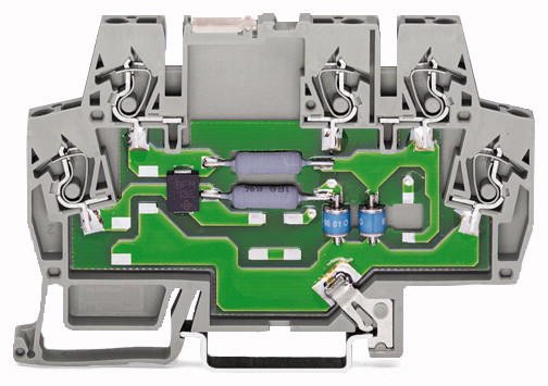

| Parameters / Models | 792-800![]() | 792-801![]() | 792-802![]() | 792-803![]() | 792-804![]() | 792-805![]() |
| Capacity line/PG | ≤ 1 nF | ≤ 5 pF | ≤ 12 pF | ≤ 6 pF | ≤ 0.6 pF | ≤ 16 pF |
| Capacity line/line | ≤ 0.5 nF | ≤ 1 nF | ≤ 1 nF | ≤ 1 nF | ≤ 10 pF | ≤ 19 pF |
| Цвет | blau | |||||
| Connection technology | CAGE CLAMP® | CAGE CLAMP® | CAGE CLAMP® | CAGE CLAMP® | CAGE CLAMP® | CAGE CLAMP® |
| Connections (number) | 5 | 5 | 5 | 5 | 5 | 5 |
| Country of origin | DE | DE | DE | DE | DE | DE |
| Габариты: глубина | 91 mm / 3.583 inch | 91 mm / 3.583 inch | 91 mm / 3.583 inch | 91 mm / 3.583 inch | 91 mm / 3.583 inch | 91 mm / 3.583 inch |
| Fine-stranded conductor | 0.08 … 2.5 mm² / 28 … 14 AWG | 0.08 … 2.5 mm² / 28 … 14 AWG | 0.08 … 2.5 mm² / 28 … 14 AWG | 0.08 … 2.5 mm² / 28 … 14 AWG | 0.08 … 2.5 mm² / 28 … 14 AWG | 0.08 … 2.5 mm² / 28 … 14 AWG |
| GTIN | 4017332780735 | 4017332780742 | 4017332780759 | 4017332780766 | 4017332780773 | 4017332843737 |
| Height from upper-edge of DIN-35 rail | 56 mm / 2.205 inch | 56 mm / 2.205 inch | 56 mm / 2.205 inch | 56 mm / 2.205 inch | 56 mm / 2.205 inch | 56 mm / 2.205 inch |
| Impedance, Ω | 1.8 | 1.8 | 1.8 | 0.4 | 1 | |
| Limit frequency line/line, МГц | 6 | 6 | 7 | 6 | 10 | 250 |
| Max. Input voltage acc. to EN 50020 Ui, В | 30 | |||||
| Max. input current acc. to EN 50020 Ii, A | 0.5 | |||||
| Maximum continuous operating voltage | 23 VAC / 33 VDC | 23 VAC / 33 VDC | 23 VAC / 33 VDC | 23 VAC / 33 VDC | 38.5 VAC / 55 VDC | 4.2 VAC / 6 VDC |
| Nominal current, A | 0.5 | 0.5 | 10 | 0.5 | 1.7 | 0.1 |
| Nominal discharge current (8/20 µs) in total | 10 kA | 10 kA | 5 kA | 10 kA | 10 kA | 10 kA |
| Nominal discharge current (8/20 µs) per line | 5 kA | 5 kA | 300 A | 5 kA | 5 kA | 5 kA |
| Nominal operating voltage | 24 VDC | 24 VDC | 24 VDC | 24 VDC | 48 VDC | 5 VDC |
| Product Group | 21 (Special Products Electronic) | 21 (Special Products Electronic) | 21 (Special Products Electronic) | 21 (Special Products Electronic) | 21 (Special Products Electronic) | 21 (Special Products Electronic) |
| Response time line/PG | ≤ 1 ns | ≤ 100 ns | ≤ 100 ns | ≤ 100 ns | ≤ 100 ns | |
| Response time line/line | ≤ 1 ns | ≤ 1 ns | ≤ 1 ns | ≤ 1 ns | ||
| Solid conductor | 0.08 … 2.5 mm² / 28 … 14 AWG | 0.08 … 2.5 mm² / 28 … 14 AWG | 0.08 … 2.5 mm² / 28 … 14 AWG | 0.08 … 2.5 mm² / 28 … 14 AWG | 0.08 … 2.5 mm² / 28 … 14 AWG | 0.08 … 2.5 mm² / 28 … 14 AWG |
| Standards/specifications | IEC 61643-21 | IEC 61643-21 | IEC 61643-21 | IEC 61643-21 | IEC 61643-21 | IEC 61131-3 |
| Strip length | 5 … 6 mm / 0.2 … 0.24 Inch | 5 … 6 mm / 0.2 … 0.24 Inch | 5 … 6 mm / 0.2 … 0.24 Inch | 5 … 6 mm / 0.2 … 0.24 Inch | 5 … 6 mm / 0.2 … 0.24 Inch | 5 … 6 mm / 0.2 … 0.24 Inch |
| Surrounding air (operating) temperature | -40 … 80 °C | -40 … 80 °C | -40 … 80 °C | -40 … 80 °C | -40 … 80 °C | -40 … 80 °C |
| Surrounding air (storage) temperature | -40 … 80 °C | -40 … 80 °C | -40 … 80 °C | -40 … 80 °C | -40 … 80 °C | -40 … 80 °C |
| Type of mounting | DIN-35 rail | DIN-35 rail | DIN-35 rail | DIN-35 rail | DIN-35 rail | DIN-35 rail |
| Voltage protection level line/PG (cat. C2 at IN) | ≤ 110 V | ≤ 750 V | ≤ 750 V | ≤ 50 V | ≤ 750 V | ≤ 50 V |
| Voltage protection level line/PG (cat. C3 at IN) | ≤ 45 V | ≤ 650 V | ≤ 650 V | ≤ 1.4 kV | ≤ 650 V | ≤ 14 V |
| Voltage protection level line/line (cat. C2 at IN) | ≤ 65 V | ≤ 50 V | ≤ 50 V | ≤ 1.5 kV | ≤ 100 V | ≤ 27 V |
| Voltage protection level line/line (cat. C3 at IN) | ≤ 90 V | ≤ 45 V | ≤ 45 V | ≤ 45 V | ≤ 70 V | ≤ 14 V |
| Вес, г | 38.8 | 38.7 | 38 | 38.3 | 39.4 | 38 |
| Ширина | 6 mm / 0.236 inch | 6 mm / 0.236 inch | 6 mm / 0.236 inch | 6 mm / 0.236 inch | 6 mm / 0.236 inch | 6 mm / 0.236 inch |
