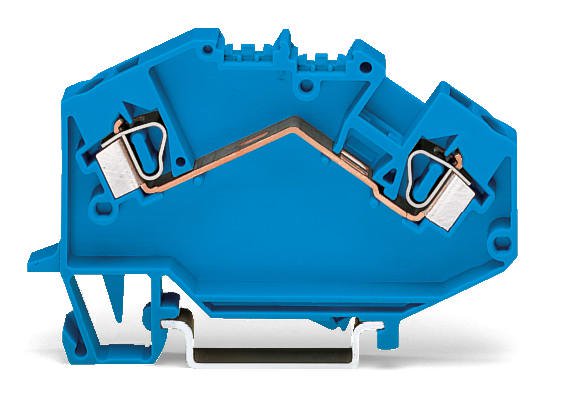

Parameters / Models | 781-452![]() | 781-453![]() | 781-454![]() | 781-455![]() | 781-456![]() | 781-601![]() | 781-604![]() | 781-607![]() | 781-607/999-950![]() | 781-623![]() | 781-631![]() | 781-637![]() | 781-637/999-950![]() | 781-651![]() | 781-653![]() | 781-992![]() | 781-993![]() |
Actuation type | Operating tool | Operating tool | Operating tool | Operating tool | Operating tool | Operating tool | Operating tool | Operating tool | Operating tool | Operating tool | Operating tool | Operating tool | |||||
Цвет | gray | gray | gray | gray | gray | gray | blue | green-yellow | green-yellow | gray | gray | green-yellow | green-yellow | blue | gray | light gray | light gray |
Connectable conductor materials | Copper | Copper | Copper | Copper | Copper | Copper | Copper | Copper | Copper | Copper | Copper | Copper | |||||
Connection technology | CAGE CLAMP® | CAGE CLAMP® | CAGE CLAMP® | CAGE CLAMP® | CAGE CLAMP® | CAGE CLAMP® | CAGE CLAMP® | CAGE CLAMP® | CAGE CLAMP® | CAGE CLAMP® | CAGE CLAMP® | CAGE CLAMP® | |||||
Country of origin | DE | DE | DE | DE | DE | DE | DE | DE | DE | PL | DE | DE | DE | DE | PL | DE | DE |
Габариты: глубина | 6 mm / 0.236 inch | 6 mm / 0.236 inch | 6 mm / 0.236 inch | 6 mm / 0.236 inch | 6 mm / 0.236 inch | 77 mm / 3.031 inch | 77 mm / 3.031 inch | 77 mm / 3.031 inch | 77 mm / 3.031 inch | 77 mm / 3.031 inch | 77 mm / 3.031 inch | 77 mm / 3.031 inch | 77 mm / 3.031 inch | 77 mm / 3.031 inch | 77 mm / 3.031 inch | 77 mm / 3.031 inch | 77 mm / 3.031 inch |
Design | angled | angled | angled | angled | angled | angled | angled | angled | angled | angled | angled | angled | |||||
Fine-stranded conductor | 0.08 … 4 mm² / 28 … 12 AWG | 0.08 … 4 mm² / 28 … 12 AWG | 0.08 … 4 mm² / 28 … 12 AWG | 0.08 … 4 mm² / 28 … 12 AWG | 0.08 … 4 mm² / 28 … 12 AWG | 0.08 … 4 mm² / 28 … 12 AWG | 0.08 … 4 mm² / 28 … 12 AWG | 0.08 … 4 mm² / 28 … 12 AWG | 0.08 … 4 mm² / 28 … 12 AWG | 0.08 … 4 mm² / 28 … 12 AWG | 0.08 … 4 mm² / 28 … 12 AWG | 0.08 … 4 mm² / 28 … 12 AWG | |||||
Fire load, MJ | 0.007 | 0.011 | 0.014 | 0.016 | 0.019 | 0.206 | 0.206 | 0.211 | 0.196 | 0.196 | 0.207 | 0.183 | 0.211 | ||||
GTIN | 4044918270854 | 4044918270892 | 4044918270946 | 4044918270991 | 4044918271042 | 4044918684316 | 4044918684347 | 4045454084691 | 4045454092580 | 4044918813341 | 4044918501231 | 4045454084714 | 4045454092672 | 4044918501262 | 4044918808101 | 4044918684392 | 4044918501309 |
Height from upper-edge of DIN-35 rail | 43.5 mm / 1.713 inch | 43.5 mm / 1.713 inch | 43.5 mm / 1.713 inch | 43.5 mm / 1.713 inch | 43.5 mm / 1.713 inch | 43.5 mm / 1.713 inch | 43.5 mm / 1.713 inch | 43.5 mm / 1.713 inch | 43.5 mm / 1.713 inch | 43.5 mm / 1.713 inch | 43.5 mm / 1.713 inch | 43.5 mm / 1.713 inch | |||||
Insulating material | Polyamide 66 (PA 66) | Polyamide 66 (PA 66) | Polyamide 66 (PA 66) | Polyamide 66 (PA 66) | Polyamide 66 (PA 66) | Polyamide 66 (PA 66) | Polyamide 66 (PA 66) | Polyamide 66 (PA 66) | Polyamide 66 (PA 66) | Polyamide 66 (PA 66) | |||||||
Legend (ratings) | (III / 3) ≙ Overvoltage category III / Pollution degree 3 | (III / 3) ≙ Overvoltage category III / Pollution degree 3 | (III / 3) ≙ Overvoltage category III / Pollution degree 3 | (III / 3) ≙ Overvoltage category III / Pollution degree 3 | (III / 3) ≙ Overvoltage category III / Pollution degree 3 | (III / 3) ≙ Overvoltage category III / Pollution degree 3 | |||||||||||
Marking level | Center marking | Center marking | Center marking | Center marking | Center marking | Center marking | Center marking | Center marking | Center marking | Center marking | Center marking | Center marking | |||||
Number of levels | 1 | 1 | 1 | 1 | 1 | 1 | 1 | 1 | 1 | 1 | 1 | 1 | |||||
Product Group | 17 (TOP JOB installation terminal blocks) | 17 (TOP JOB installation terminal blocks) | 17 (TOP JOB installation terminal blocks) | 17 (TOP JOB installation terminal blocks) | 17 (TOP JOB installation terminal blocks) | 17 (TOP JOB installation terminal blocks) | |||||||||||
Rated current, A | 32 | 32 | 32 | 32 | 32 | 32 | 32 | 32 | 32 | 32 | 32 | ||||||
Rated impulse voltage (III / 3), kV | 6 | 6 | 6 | 6 | 6 | 8 | 8 | 6 | 8 | 8 | 6 | ||||||
Rated voltage (III / 3), В | 400 | 400 | 400 | 400 | 400 | 1000 | 1000 | 400 | 1000 | 1000 | 400 | ||||||
Rated voltage EN (Ex e II), В | 750 | 750 | |||||||||||||||
Solid conductor | 0.08 … 4 mm² / 28 … 12 AWG | 0.08 … 4 mm² / 28 … 12 AWG | 0.08 … 4 mm² / 28 … 12 AWG | 0.08 … 4 mm² / 28 … 12 AWG | 0.08 … 4 mm² / 28 … 12 AWG | 0.08 … 4 mm² / 28 … 12 AWG | 0.08 … 4 mm² / 28 … 12 AWG | 0.08 … 4 mm² / 28 … 12 AWG | 0.08 … 4 mm² / 28 … 12 AWG | 0.08 … 4 mm² / 28 … 12 AWG | 0.08 … 4 mm² / 28 … 12 AWG | 0.08 … 4 mm² / 28 … 12 AWG | |||||
Strip length | 9 … 10 mm / 0.35 … 0.39 Inch | 9 … 10 mm / 0.35 … 0.39 Inch | 9 … 10 mm / 0.35 … 0.39 Inch | 9 … 10 mm / 0.35 … 0.39 Inch | 9 … 10 mm / 0.35 … 0.39 Inch | 9 … 10 mm / 0.35 … 0.39 Inch | 9 … 10 mm / 0.35 … 0.39 Inch | 9 … 10 mm / 0.35 … 0.39 Inch | 9 … 10 mm / 0.35 … 0.39 Inch | 9 … 10 mm / 0.35 … 0.39 Inch | 9 … 10 mm / 0.35 … 0.39 Inch | 9 … 10 mm / 0.35 … 0.39 Inch | |||||
Total number of connection points | 2 | 2 | 2 | 2 | 1 | 3 | 3 | 3 | 3 | 2 | 2 | 3 | |||||
Total number of potentials | 1 | 1 | 1 | 1 | 1 | 1 | 1 | 1 | 1 | 1 | 1 | 1 | |||||
Type of mounting | DIN-35 rail | DIN-35 rail | DIN-35 rail | DIN-35 rail | DIN-35 rail | DIN-35 rail | DIN-35 rail | DIN-35 rail | DIN-35 rail | DIN-35 rail | DIN-35 rail | DIN-35 rail | |||||
Type of wiring | Front-entry wiring | Front-entry wiring | Front-entry wiring | Front-entry wiring | Front-entry wiring | Front-entry wiring | Front-entry wiring | Front-entry wiring | Front-entry wiring | Front-entry wiring | Front-entry wiring | Front-entry wiring | |||||
Вес, г | 1.696 | 1.99 | 2.322 | 2.66 | 2.96 | 10.414 | 10.324 | 16.65 | 16.65 | 16.384 | 11.706 | 18.07 | 18.07 | 11.7 | 17.91 | 9.564 | 11.536 |
Ширина | 5.4 mm / 0.213 inch | 11.4 mm / 0.449 inch | 17.4 mm / 0.685 inch | 23.4 mm / 0.921 inch | 29.4 mm / 1.157 inch | 6 mm / 0.236 inch | 6 mm / 0.236 inch | 6 mm / 0.236 inch | 6 mm / 0.236 inch | 6 mm / 0.236 inch | 6 mm / 0.236 inch | 6 mm / 0.236 inch | 6 mm / 0.236 inch | 6 mm / 0.236 inch | 6 mm / 0.236 inch | 6 mm / 0.236 inch | 6 mm / 0.236 inch |
