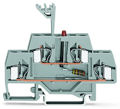

Datasheet Wago 281-634/281-434 — Даташит
Двухуровневая светодиодная клеммная колодка; с красным светодиодом (PN); 24 В постоянного тока; крепление на рейку; 4-проводная; ширина 6 мм; серая

| Actuation type | Operating tool |
| Цвет | gray |
| Connectable conductor materials | Copper |
| Connection technology | CAGE CLAMP® |
| Country of origin | DE |
| Габариты: глубина | 73.5 mm / 2.894 inch |
| Design | horizontal |
| Fine-stranded conductor | 0.08 … 4 mm² / 28 … 12 AWG |
| Fire load | 0.218 MJ |
| GTIN | 4045454371500 |
| Height from upper-edge of DIN-35 rail | 58.5 mm / 2.303 inch |
| Insulating material | Polyamide 66 (PA 66) |
| Marking level | Center marking |
| Nominal voltage | 24 В |
| Number of levels | 2 |
| Product Group | 1 (Rail Mounted Terminal Blocks) |
| Solid conductor | 0.08 … 4 mm² / 28 … 12 AWG |
| Strip length | 9 … 10 mm / 0.35 … 0.39 Inch |
| Total number of connection points | 4 |
| Total number of potentials | 2 |
| Type of mounting | DIN-35 rail |
| Type of wiring | Front-entry wiring |
| Voltage type (1) | DC |
| Вес | 15.753 г |
| Ширина | 6 mm / 0.236 inch |
