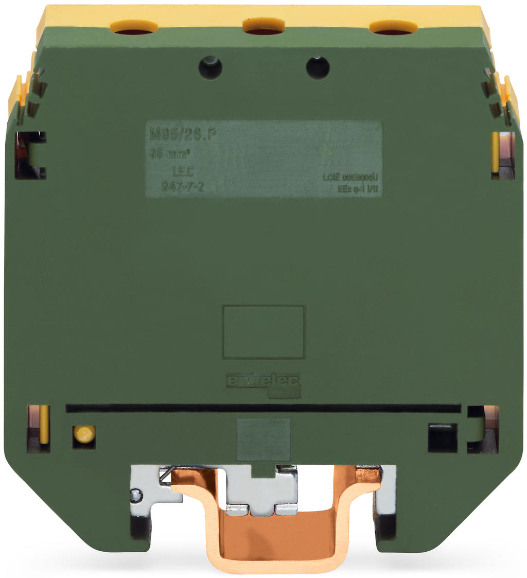

Datasheet Wago 400-499/499-176 — Даташит
3-проводная клеммная колодка заземления; 95 мм²; с контактом к DIN-рейке; для DIN-рейки 35 x 15 и 35 x 7,5; толщина 2,3 мм; медь
| 400-499/499-715, 2-конт. зажим, 150 мм2 | |||
| 400-499/499-024 Wago | по запросу | ||
| 400-499/499-715 Wago Оф. дистрибьютор | по запросу | ||
| Actuation type | Operating tool |
| Цвет | green-yellow |
| Connectable conductor materials | Copper |
| Connection technology | Screw-clamp connection/Studs |
| Country of origin | FR |
| Габариты: глубина | 87 mm / 3.425 inch |
| Design | horizontal |
| GTIN | 4045454827496 |
| Height from upper-edge of DIN-35 rail | 72 mm / 2.835 inch |
| Legend (ratings) | (III / 3) ≙ Overvoltage category III / Pollution degree 3 |
| Marking level | Side marking |
| Number of levels | 1 |
| Solid conductor | 35 … 95 mm² / 2 … 4/0 AWG |
| Strip length | 25 … 27 mm / 0.98 … 1.06 Inch |
| Total number of connection points | 2 |
| Total number of potentials | 1 |
| Type of mounting | DIN-35 rail |
| Type of wiring | Side-entry wiring |
| Вес | 292 г |
| Ширина | 26 mm / 1.024 inch |
