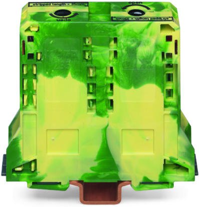

Datasheet Wago 285-197/999-950 — Даташит
2-проводная клеммная колодка заземления; 95 мм²; подходит для применений Ex e II; боковые пазы для маркеров; только для рейки DIN 35 x 15; POWER CAGE CLAMP
2-CONDUCTOR GROUND TERMINAL BLOC | |||
| 285-197/999-950 Wago | по запросу | ||
| Actuation type | Operating tool |
| Цвет | green-yellow |
| Connectable conductor materials | Copper |
| Connection technology | POWER CAGE CLAMP |
| Country of origin | PL |
| Габариты: глубина | 107 mm / 4.213 inch |
| Design | horizontal |
| Fine-stranded conductor | 35 … 70 mm² / 2 … 2/0 AWG |
| Fire load | 3.384 MJ |
| GTIN | 4045454204389 |
| Height from upper-edge of DIN-35 rail | 101 mm / 3.976 inch |
| Insulating material | Polyamide 66 (PA 66) |
| Marking level | Side marking |
| Number of levels | 1 |
| Solid conductor | 35 … 70 mm² / 2 … 2/0 AWG |
| Strip length | 35 mm / 1.38 Inch |
| Total number of connection points | 2 |
| Total number of potentials | 1 |
| Type of mounting | DIN-35 rail |
| Type of wiring | Side-entry wiring |
| Вес | 309.278 г |
| Ширина | 25 mm / 0.984 inch |
