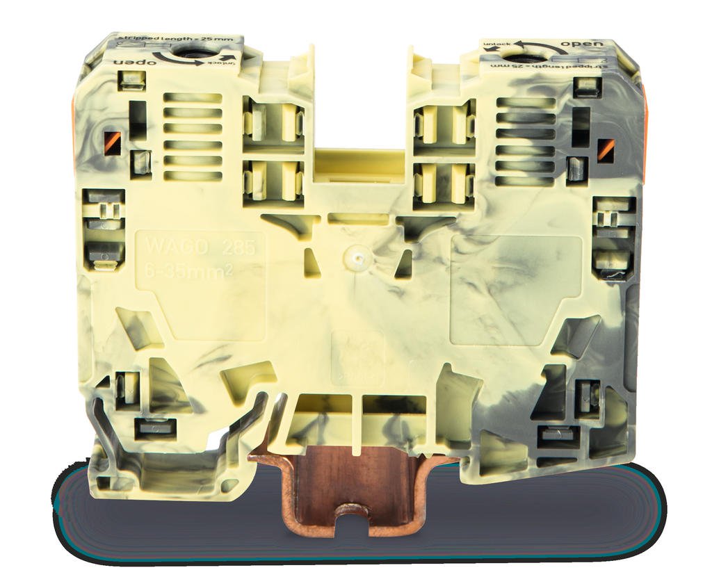

Datasheet Wago 285-131 — Даташит
2-проводная проходная клеммная колодка; 35 мм²; боковые пазы для маркеров; только для рейки DIN 35 x 15; толщина 2,3 мм; медь; POWER CAGE CLAMP

Actuation type | Operating tool |
Цвет | dark gray-yellow |
Connectable conductor materials | Copper |
Connection technology | POWER CAGE CLAMP |
Country of origin | PL |
Габариты: глубина | 86 mm / 3.386 inch |
Design | horizontal |
Fine-stranded conductor | 6 … 35 mm² / 10 … 2 AWG |
GTIN | 4055143500838 |
Height from upper-edge of DIN-35 rail | 63 mm / 2.48 inch |
Legend (ratings) | (III / 3) ≙ Overvoltage category III / Pollution degree 3 |
Marking level | Side marking |
Number of levels | 1 |
Rated current | 125 A |
Rated impulse voltage (III / 3) | 8 kV |
Rated voltage (III / 3) | 1000 В |
Solid conductor | 6 … 35 mm² / 10 … 2 AWG |
Strip length | 25 mm / 0.98 Inch |
Total number of connection points | 2 |
Total number of potentials | 1 |
Type of mounting | DIN-35 rail |
Type of wiring | Side-entry wiring |
Вес | 79.291 г |
Ширина | 16 mm / 0.63 inch |
