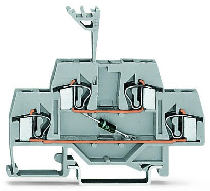

Двухъярусная диодная клеммная колодка; с диодом 1N4007
COMPONENT TERMINAL BLOCK; DOUBLE | |||
281-633/281-411 Wago | 369 ₽ | ||
281-633/281-411 Wago | по запросу |
Actuation type | Operating tool |
Цвет | gray |
Connectable conductor materials | Copper |
Connection technology | CAGE CLAMP® |
Country of origin | DE |
Габариты: глубина | 73.5 mm / 2.894 inch |
Design | horizontal |
Fine-stranded conductor | 0.08 … 4 mm² / 28 … 12 AWG |
Fire load | 0.231 MJ |
GTIN | 4045454197230 |
Height from upper-edge of DIN-35 rail | 58.5 mm / 2.303 inch |
Marking level | Center marking |
Nominal voltage | 250 В |
Number of levels | 2 |
Product Group | 1 (Rail Mounted Terminal Blocks) |
Reverse voltage | 1000 В |
Solid conductor | 0.08 … 4 mm² / 28 … 12 AWG |
Strip length | 9 … 10 mm / 0.35 … 0.39 Inch |
Total number of connection points | 4 |
Total number of potentials | 2 |
Type of mounting | DIN-35 rail |
Type of wiring | Front-entry wiring |
Вес | 14.254 г |
Ширина | 6 mm / 0.236 inch |
