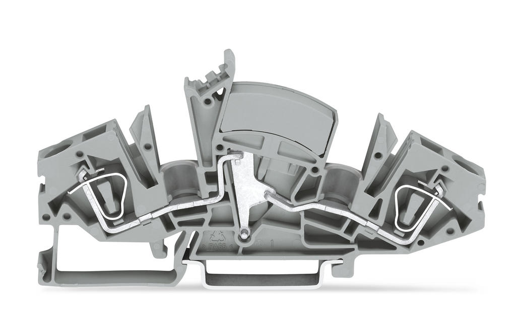

Datasheet Wago 282-841/049-000 — Даташит
2-проводная проходная клеммная колодка; 6 мм²; без тестовых гнезд; боковая и центральная маркировка; для DIN-рейки 35 x 15 и 35 x 7,5; CAGE CLAMP
Цены
2-CONDUCTOR THROUGH TERMINAL BLO | |||
282-841/049-000 Wago | по запросу |
Actuation type | Operating tool |
Цвет | gray |
Connectable conductor materials | Copper |
Connection technology | CAGE CLAMP® |
Country of origin | CN |
Габариты: глубина | 98 mm / 3.858 inch |
Design | angled |
Fine-stranded conductor | 0.2 … 6 mm² / 24 … 10 AWG |
Fire load | 0.35 MJ |
GTIN | 4050821227540 |
Height from upper-edge of DIN-35 rail | 46.5 mm / 1.831 inch |
Legend (ratings) | (III / 3) ≙ Overvoltage category III / Pollution degree 3 |
Marking level | Center/side marking |
Number of levels | 1 |
Product Group | 1 (Rail Mounted Terminal Blocks) |
Rated current | 30 A |
Rated impulse voltage (III / 3) | 6 kV |
Rated voltage (III / 3) | 500 В |
Solid conductor | 0.2 … 6 mm² / 24 … 10 AWG |
Strip length | 12 … 13 mm / 0.47 … 0.51 Inch |
Total number of connection points | 2 |
Total number of potentials | 1 |
Type of mounting | DIN-35 rail |
Type of wiring | Front-entry wiring |
Вес | 20.596 г |
Ширина | 8 mm / 0.315 inch |
