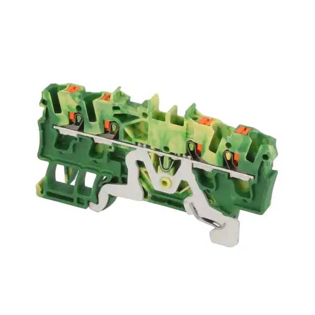

Клеммная колодка заземления TOPJOB S с кнопками; монтаж на рейку; 4-проводная; ширина 5,2 мм; желто-зеленая

Actuation typePush-button
Цветgreen-yellow
Connectable conductor materialsCopper
Connection technologyPush-in CAGE CLAMP®
Country of originDE
Габариты: глубина69.9 mm / 2.752 inch
Designhorizontal
Fine-stranded conductor0.25 … 4 mm² / 22 … 12 AWG
Fine-stranded conductor with ferrule, push-in termination, from0.75 mm² / 18 AWG
Fire load0.151 MJ
GTIN4055143713917
Height from upper-edge of DIN-35 rail32.9 mm / 1.295 inch
Insulating materialPolyamide 66 (PA 66)
Marking levelCenter/side marking
Nominal cross section2.5 mm²
Number of levels1
Packaging typeBOX
Solid conductor0.25 … 4 mm² / 22 … 12 AWG
Solid conductor, push-in termination0.75 … 4 mm² / 18 … 12 AWG
Strip length10 … 12 mm / 0.39 … 0.47 Inch
Total number of connection points4
Total number of potentials1
Type of mountingDIN-35 rail
Type of wiringFront-entry wiring
Вес10.794 г
Ширина5.2 mm / 0.205 inch
