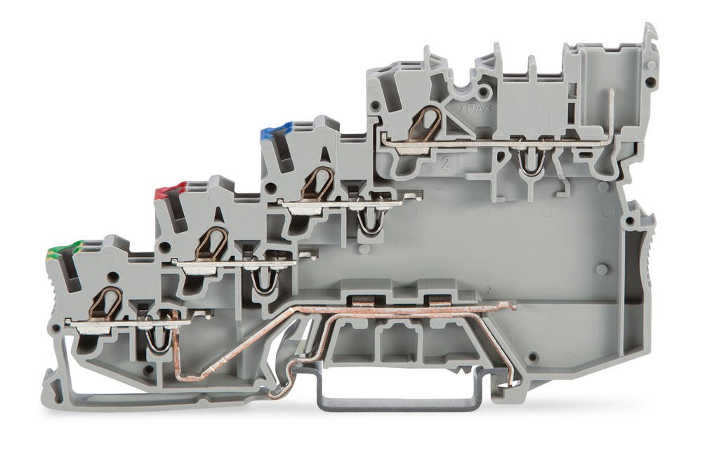

Datasheet Wago 2020-5417 — Даташит
4-проводная клеммная колодка датчика; с заземляющим контактом; 1 мм²; Push-in CAGE CLAMP
![]() 6 предложений от 3 поставщиков 4-CONDUCTOR SENSOR TERMINAL BLOC | |||
2020-5417 Wago | 2 973 ₽ | ||
2020-5417 Wago | от 3 564 ₽ | ||
2020-5417/1102-950 Wago | по запросу |
Actuation type | Open Tool Slot |
Цвет | gray |
Connectable conductor materials | Copper |
Connection technology | Push-in CAGE CLAMP® |
Country of origin | DE |
Design | horizontal |
Fine-stranded conductor | 0.14 … 1.5 mm² / 24 … 16 AWG |
Fine-stranded conductor with ferrule, push-in termination, from | 0.5 mm² / 20 AWG |
GTIN | 4055143525503 |
Height from upper-edge of DIN-35 rail | 52.4 mm / 2.063 inch |
Legend (ratings) | (III / 3) ≙ Overvoltage category III / Pollution degree 3 |
Marking level | Center/side marking |
Nominal cross section | 1 mm² |
Rated current | 13.5 A |
Rated impulse voltage (III / 3) | 4 kV |
Rated voltage (III / 3) | 250 В |
Solid conductor | 0.14 … 1.5 mm² / 24 … 16 AWG |
Solid conductor, push-in termination | 0.5 … 1.5 mm² / 20 … 16 AWG |
Strip length | 9 … 11 mm / 0.35 … 0.43 Inch |
Total number of connection points | 8 |
Total number of potentials | 5 |
Type of mounting | DIN-35 rail |
Type of wiring | Front-entry wiring |
Вес | 20.496 г |
Ширина | 7 mm / 0.276 inch |
