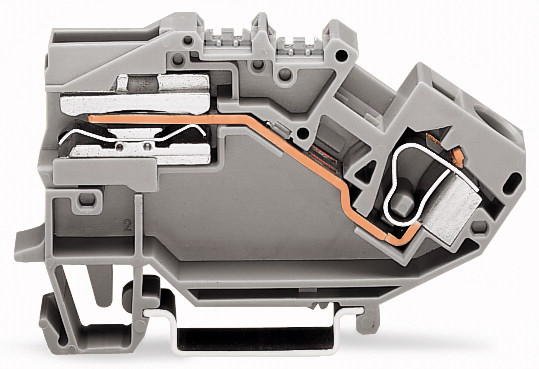

Клеммная колодка с 1-проводным распределением питания; 10 мм²; CAGE CLAMP
Augswan
784-623
Wago
Actuation typeOperating tool
Цветgray
Connectable conductor materialsCopper
Connection technologyCAGE CLAMP®
Country of originPL
Габариты: глубина82.5 mm / 3.248 inch
Designangled
Fine-stranded conductor0.2 … 10 mm² / 24 … 8 AWG
Fine-stranded conductor (2)0.2 … 16 mm² / 24 … 6 AWG
GTIN4045454016999
Height from upper-edge of DIN-35 rail43.5 mm / 1.713 inch
Legend (ratings)(III / 3) ≙ Overvoltage category III / Pollution degree 3
Marking levelCenter marking
Number of levels1
Product Group17 (TOP JOB installation terminal blocks)
Rated current57 A
Rated impulse voltage (III / 3)6 kV
Rated voltage (III / 3)400 В
Solid conductor0.2 … 10 mm² / 24 … 8 AWG
Solid conductor (2)0.2 … 16 mm² / 24 … 6 AWG
Strip length12 … 13 mm / 0.47 … 0.51 Inch
Total number of connection points1
Total number of potentials1
Type of mountingDIN-35 rail
Type of wiringFront-entry wiring
Вес32.92 г
Ширина10 mm / 0.394 inch
