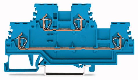

Двухуровневый клеммный блок; Сквозной/сквозной клеммный блок; N/N; подходит для применений Ex i; для DIN-рейки 35 x 15 и 35 x 7,5; 1,5 мм²; CAGE CLAMP
| DOUBLE-DECK TERMINAL BLOCK, THRO | |||
| 279-504 Wago | по запросу | ||
| Actuation type | Operating tool |
| Цвет | blue |
| Connectable conductor materials | Copper |
| Connection technology | CAGE CLAMP® |
| Country of origin | DE |
| Габариты: глубина | 85 mm / 3.346 inch |
| Design | horizontal |
| Fine-stranded conductor | 0.08 … 1.5 mm² / 28 … 16 AWG |
| Fire load | 0.145 MJ |
| GTIN | 4050821109327 |
| Height from upper-edge of DIN-35 rail | 39 mm / 1.535 inch |
| Insulating material | Polyamide 66 (PA 66) |
| Legend (ratings) | (III / 3) ≙ Overvoltage category III / Pollution degree 3 |
| Marking level | Side marking |
| Number of levels | 2 |
| Potential marking | N/N |
| Product Group | 1 (Rail Mounted Terminal Blocks) |
| Rated current | 18 A |
| Rated impulse voltage (III / 3) | 6 kV |
| Rated voltage (III / 3) | 500 В |
| Solid conductor | 0.08 … 1.5 mm² / 28 … 16 AWG |
| Strip length | 8 … 9 mm / 0.31 … 0.35 Inch |
| Total number of connection points | 4 |
| Total number of potentials | 2 |
| Type of mounting | DIN-35 rail |
| Type of wiring | Front-entry wiring |
| Вес | 7 г |
| Ширина | 4 mm / 0.157 inch |
