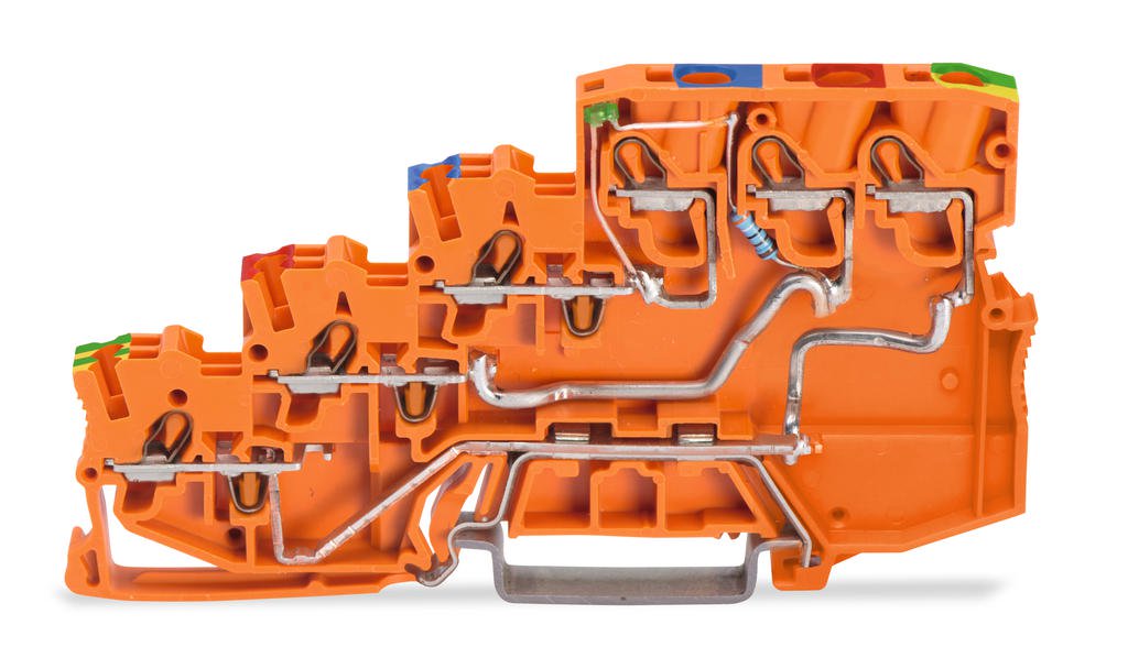

Datasheet Wago 2000-5457/1102-953 — Даташит
Клеммная колодка светодиода датчика TOPJOB S; зеленый светодиод; с заземляющим контактом со стороны панели управления; 2-полюсный; монтаж на рейку; 4-проводной; ширина 7 мм; оранжевый

| Actuation type | Open Tool Slot |
| Цвет | orange |
| Connectable conductor materials | Copper |
| Connection technology | Push-in CAGE CLAMP® |
| Country of origin | DE |
| Design | horizontal |
| Fine-stranded conductor | 0.14 … 1.5 mm² / 24 … 16 AWG |
| Fine-stranded conductor (2) | 0.25 … 4 mm² / 22 … 12 AWG |
| Fine-stranded conductor with ferrule, push-in termination, from | 0.5 mm² / 20 AWG |
| Fire load | 0.357 MJ |
| GTIN | 4055143533195 |
| Height from upper-edge of DIN-35 rail | 49.4 mm / 1.945 inch |
| Insulating material | Polyamide 66 (PA 66) |
| Legend (ratings) | (III / 3) ≙ Overvoltage category III / Pollution degree 3 |
| Marking level | Center/side marking |
| Nominal cross section | 1 mm² |
| Rated current | 28 A |
| Rated voltage (III / 3) | 250 В |
| Solid conductor | 0.14 … 1.5 mm² / 24 … 16 AWG |
| Solid conductor (2) | 0.25 … 4 mm² / 22 … 12 AWG |
| Solid conductor, push-in termination | 0.5 … 1.5 mm² / 20 … 16 AWG |
| Solid conductor, push-in termination (2) | 0.25 … 4 mm² / 22 … 12 AWG |
| Strip length | 9 … 11 mm / 0.35 … 0.43 Inch |
| Total number of connection points | 8 |
| Total number of potentials | 3 |
| Type of mounting | DIN-35 rail |
| Type of wiring | Front-entry wiring |
| Вес | 24.266 г |
| Ширина | 7 mm / 0.276 inch |
