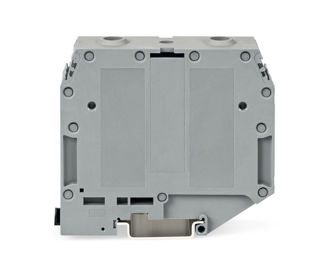

Клеммная колодка винтового типа; 95 мм²; для DIN-рейки 35 x 15 и 35 x 7,5
400-415/415-124 Wago | по запросу | ||
400-415/415-195 | по запросу |
Actuation type | Operating tool |
Цвет | gray |
Connectable conductor materials | Copper |
Connection technology | Screw-clamp connection/Studs |
Country of origin | FR |
Габариты: глубина | 95 mm / 3.74 inch |
Design | horizontal |
GTIN | 4017332186872 |
Height from upper-edge of DIN-35 rail | 72.5 mm / 2.854 inch |
Legend (ratings) | (III / 3) ≙ Overvoltage category III / Pollution degree 3 |
Marking level | Side marking |
Number of levels | 1 |
Product Group | 1 (Rail Mounted Terminal Blocks) |
Rated current | 232 A |
Rated impulse voltage (III / 3) | 8 kV |
Rated voltage (III / 3) | 1000 В |
Solid conductor | 35 … 95 mm² / 2 … 4/0 AWG |
Strip length | 25 … 27 mm / 0.98 … 1.06 Inch |
Total number of connection points | 2 |
Total number of potentials | 1 |
Type of mounting | DIN-35 rail |
Type of wiring | Side-entry wiring |
Вес | 232.69 г |
Ширина | 26 mm / 1.024 inch |
