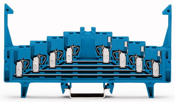

4-уровневая клеммная колодка для коммутации матрицы
4-LEVEL TERMINAL BLOCK FOR MATRI | |||
| 727-223 Wago | по запросу | ||
| 727-223/024-000 Wago | по запросу | ||
| Actuation type | Operating tool |
| Цвет | blue |
| Connectable conductor materials | Copper |
| Connection technology | CAGE CLAMP® |
| Country of origin | DE |
| Габариты: глубина | 126 mm / 4.961 inch |
| Design | horizontal |
| Fine-stranded conductor | 0.08 … 1.5 mm² / 28 … 16 AWG |
| Fire load | 0.576 MJ |
| GTIN | 4045454188900 |
| Height from upper-edge of DIN-35 rail | 62 mm / 2.441 inch |
| Insulating material | Polyamide 66 (PA 66) |
| Legend (ratings) | (III / 3) ≙ Overvoltage category III / Pollution degree 3 |
| Marking | 0-1-2-3--3-2-1-0 |
| Marking level | Center marking |
| Number of levels | 4 |
| Rated current | 12 A |
| Rated impulse voltage (III / 3) | 4 kV |
| Rated voltage (III / 3) | 250 В |
| Solid conductor | 0.08 … 1.5 mm² / 28 … 16 AWG |
| Strip length | 8 … 10 mm / 0.31 … 0.39 Inch |
| Total number of connection points | 16 |
| Total number of potentials | 4 |
| Type of mounting | DIN-35 rail |
| Type of wiring | Front-entry wiring |
| Вес | 33.196 г |
| Ширина | 7.62 mm / 0.3 inch |
