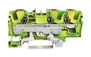

Клеммная колодка заземления TOPJOB S с кнопками; монтаж на рейку; 3-проводная; ширина 7,5 мм; желто-зеленая

Actuation typePush-button
Цветgreen-yellow
Connectable conductor materialsCopper
Connection technologyPush-in CAGE CLAMP®
Country of originDE
Габариты: глубина73.3 mm / 2.886 inch
Designhorizontal
Fine-stranded conductor0.5 … 10 mm² / 20 … 8 AWG
Fine-stranded conductor with ferrule, push-in termination, from1.5 mm² / 16 AWG
Fire load0.01 MJ
GTIN4055143712125
Height from upper-edge of DIN-35 rail32.9 mm / 1.295 inch
Insulating materialPolyamide 66 (PA 66)
Marking levelCenter/side marking
Nominal cross section6 mm²
Number of levels1
Packaging typeBOX
Solid conductor0.5 … 10 mm² / 20 … 8 AWG
Solid conductor, push-in termination1 … 10 mm² / 14 … 8 AWG
Strip length13 … 15 mm / 0.51 … 0.59 Inch
Total number of connection points3
Total number of potentials1
Type of mountingDIN-35 rail
Type of wiringFront-entry wiring
Вес20.905 г
Ширина7.5 mm / 0.295 inch
