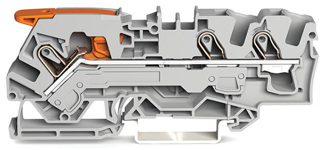

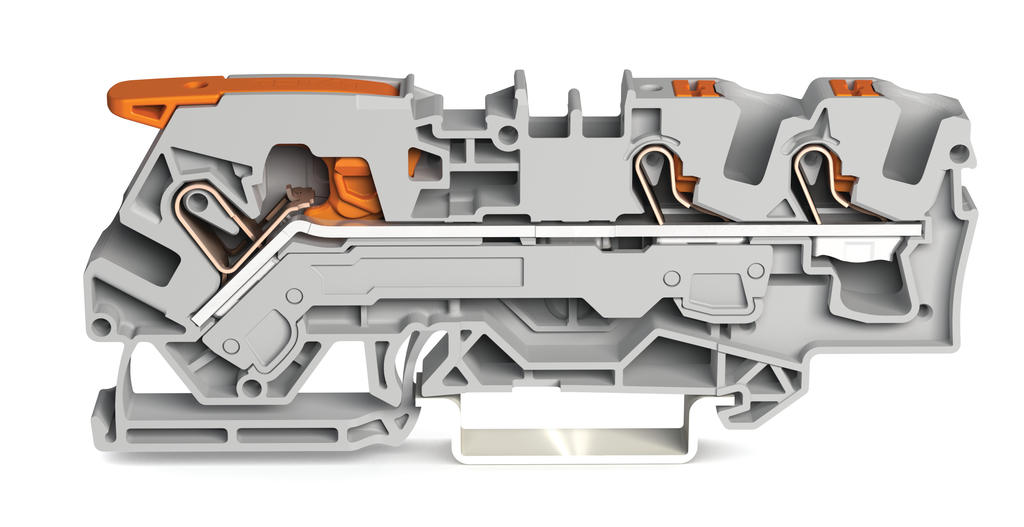

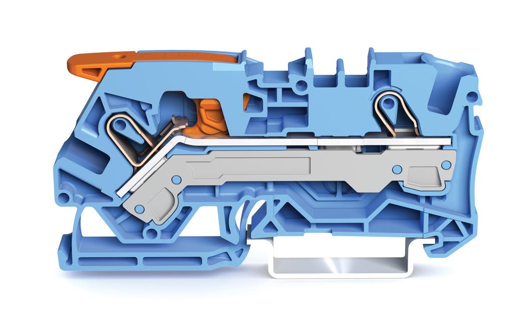

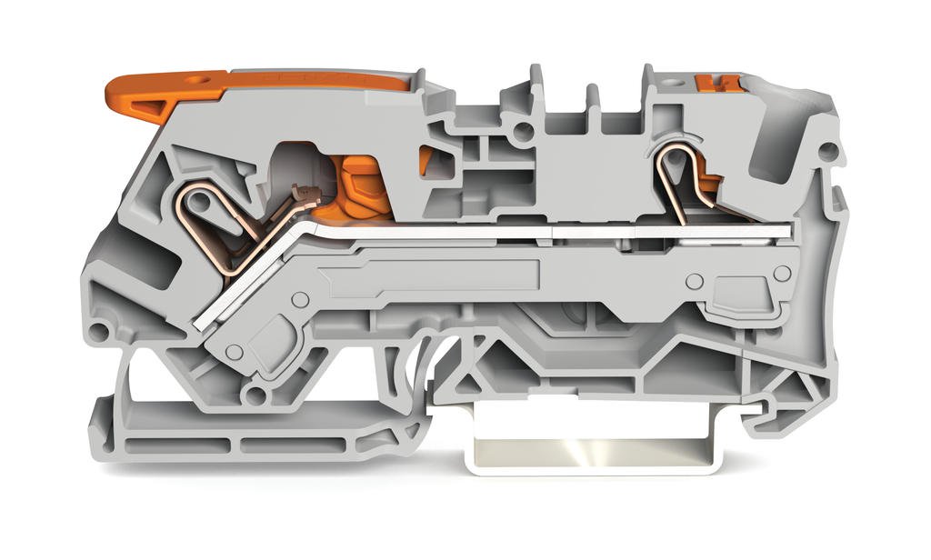

| Parameters / Models | 2106-1201  | 2106-1204  | 2106-1207  | 2106-1291  | 2106-1292  | 2106-1301  | 2106-1304  | 2106-1307  | 2106-1391  | 2106-1392  | 2106-5201  | 2106-5204  | 2106-5207  | 2106-5301  | 2106-5304  | 2106-5307  |
| Actuation type | Lever and Open Tool Slot | Lever and Open Tool Slot | Lever and Open Tool Slot | Lever and Open Tool Slot | Lever and Open Tool Slot | Lever and Open Tool Slot | Lever and Push-button | Lever and Push-button | Lever and Push-button | Lever and Push-button | Lever and Push-button | Lever and Push-button | ||||
| Actuation type 2, Push-button | Push-in | Push-in | Push-in | Push-in | Push-in | Push-in | Push-in | Push-in | Push-in | Push-in | Push-in | Push-in | ||||
| Цвет | gray | blue | green-yellow | gray | orange | gray | blue | green-yellow | gray | orange | gray | blue | green-yellow | gray | blue | green-yellow |
| Connectable conductor materials | Copper | Copper | Copper | Copper | Copper | Copper | Copper | Copper | Copper | Copper | Copper | Copper | ||||
| Connection technology | Push-in CAGE CLAMP® | Push-in CAGE CLAMP® | Push-in CAGE CLAMP® | Push-in CAGE CLAMP® | Push-in CAGE CLAMP® | Push-in CAGE CLAMP® | Push-in CAGE CLAMP® | Push-in CAGE CLAMP® | Push-in CAGE CLAMP® | Push-in CAGE CLAMP® | Push-in CAGE CLAMP® | Push-in CAGE CLAMP® | ||||
| Country of origin | DE | DE | DE | DE | DE | DE | DE | DE | DE | DE | DE | DE | DE | DE | DE | DE |
| Габариты: глубина | 74.8 mm / 2.945 inch | 74.8 mm / 2.945 inch | 75.2 mm / 2.961 inch | 74.8 mm / 2.945 inch | 74.8 mm / 2.945 inch | 90.8 mm / 3.575 inch | 90.8 mm / 3.575 inch | 91.2 mm / 3.591 inch | 90.8 mm / 3.575 inch | 90.8 mm / 3.575 inch | 74.8 mm / 2.945 inch | 74.8 mm / 2.945 inch | 75.2 mm / 2.961 inch | 90.8 mm / 3.575 inch | 90.8 mm / 3.575 inch | 91.2 mm / 3.591 inch |
| Design | horizontal | horizontal | horizontal | horizontal | horizontal | horizontal | horizontal | horizontal | horizontal | horizontal | horizontal | horizontal | ||||
| Fine-stranded conductor | 0.5 … 10 mm² / 20 … 8 AWG | 0.5 … 10 mm² / 20 … 8 AWG | 0.5 … 10 mm² / 20 … 8 AWG | 0.5 … 10 mm² / 20 … 8 AWG | 0.5 … 10 mm² / 20 … 8 AWG | 0.5 … 10 mm² / 20 … 8 AWG | 0.5 … 10 mm² / 20 … 8 AWG | 0.5 … 10 mm² / 20 … 8 AWG | 0.5 … 10 mm² / 20 … 8 AWG | 0.5 … 10 mm² / 20 … 8 AWG | 0.5 … 10 mm² / 20 … 8 AWG | 0.5 … 10 mm² / 20 … 8 AWG | ||||
| Fine-stranded conductor with ferrule, push-in termination, from | 1.5 mm² / 16 AWG | 1.5 mm² / 16 AWG | 1.5 mm² / 16 AWG | 1.5 mm² / 16 AWG | 1.5 mm² / 16 AWG | 1.5 mm² / 16 AWG | 1.5 mm² / 16 AWG | 1.5 mm² / 16 AWG | 1.5 mm² / 16 AWG | 1.5 mm² / 16 AWG | 1.5 mm² / 16 AWG | 1.5 mm² / 16 AWG | ||||
| GTIN | 4055143742016 | 4055143742023 | 4055143742030 | 4055143745383 | 4055143745390 | 4055143742054 | 4055143742061 | 4055143742221 | 4055143745406 | 4055143745413 | 4055143742450 | 4055143742467 | 4055143742474 | 4055143742481 | 4055143742498 | 4055143742504 |
| Height | 32.9 mm / 1.295 inch | 32.9 mm / 1.295 inch | 32.9 mm / 1.295 inch | 32.9 mm / 1.295 inch | ||||||||||||
| Height from upper-edge of DIN-35 rail | 32.9 mm / 1.295 inch | 32.9 mm / 1.295 inch | 32.9 mm / 1.295 inch | 32.9 mm / 1.295 inch | 32.9 mm / 1.295 inch | 32.9 mm / 1.295 inch | 32.9 mm / 1.295 inch | 32.9 mm / 1.295 inch | 32.9 mm / 1.295 inch | 32.9 mm / 1.295 inch | 32.9 mm / 1.295 inch | 32.9 mm / 1.295 inch | ||||
| Insulating material | Polyamide 66 (PA 66) | Polyamide 66 (PA 66) | Polyamide 66 (PA 66) | Polyamide 66 (PA 66) | Polyamide 66 (PA 66) | Polyamide 66 (PA 66) | Polyamide 66 (PA 66) | Polyamide 66 (PA 66) | Polyamide 66 (PA 66) | Polyamide 66 (PA 66) | Polyamide 66 (PA 66) | Polyamide 66 (PA 66) | ||||
| Legend (ratings) | (III / 3) ≙ Overvoltage category III / Pollution degree 3 | (III / 3) ≙ Overvoltage category III / Pollution degree 3 | (III / 3) ≙ Overvoltage category III / Pollution degree 3 | (III / 3) ≙ Overvoltage category III / Pollution degree 3 | (III / 3) ≙ Overvoltage category III / Pollution degree 3 | (III / 3) ≙ Overvoltage category III / Pollution degree 3 | (III / 3) ≙ Overvoltage category III / Pollution degree 3 | (III / 3) ≙ Overvoltage category III / Pollution degree 3 | ||||||||
| Marking level | Center/side marking | Center/side marking | Center/side marking | Center/side marking | Center/side marking | Center/side marking | Center/side marking | Center/side marking | Center/side marking | Center/side marking | Center/side marking | Center/side marking | ||||
| Nominal cross section | 6 mm² | 6 mm² | 6 mm² | 6 mm² | 6 mm² | 6 mm² | 6 mm² | 6 mm² | 6 mm² | 6 mm² | 6 mm² | 6 mm² | ||||
| Number of levels | 1 | 1 | 1 | 1 | 1 | 1 | 1 | 1 | 1 | 1 | 1 | 1 | ||||
| Packaging type | BOX | BOX | BOX | BOX | BOX | BOX | BOX | BOX | BOX | BOX | BOX | BOX | BOX | BOX | BOX | BOX |
| Rated current, A | 41 | 41 | 41 | 41 | 41 | 41 | 41 | 41 | ||||||||
| Rated current (2), A | 57 | 57 | 57 | 57 | 57 | 57 | 57 | 57 | ||||||||
| Rated impulse voltage (III / 3), kV | 8 | 8 | 8 | 8 | 8 | 8 | 8 | 8 | ||||||||
| Rated voltage (III / 3), В | 800 | 800 | 800 | 800 | 800 | 800 | 800 | 800 | ||||||||
| Solid conductor | 0.5 … 10 mm² / 20 … 8 AWG | 0.5 … 10 mm² / 20 … 8 AWG | 0.5 … 10 mm² / 20 … 8 AWG | 0.5 … 10 mm² / 20 … 8 AWG | 0.5 … 10 mm² / 20 … 8 AWG | 0.5 … 10 mm² / 20 … 8 AWG | 0.5 … 10 mm² / 20 … 8 AWG | 0.5 … 10 mm² / 20 … 8 AWG | 0.5 … 10 mm² / 20 … 8 AWG | 0.5 … 10 mm² / 20 … 8 AWG | 0.5 … 10 mm² / 20 … 8 AWG | 0.5 … 10 mm² / 20 … 8 AWG | ||||
| Solid conductor, push-in termination | 1 … 10 mm² / 14 … 8 AWG | 1 … 10 mm² / 14 … 8 AWG | 1 … 10 mm² / 14 … 8 AWG | 1 … 10 mm² / 14 … 8 AWG | 1 … 10 mm² / 14 … 8 AWG | 1 … 10 mm² / 14 … 8 AWG | 1 … 10 mm² / 14 … 8 AWG | 1 … 10 mm² / 14 … 8 AWG | 1 … 10 mm² / 14 … 8 AWG | 1 … 10 mm² / 14 … 8 AWG | 1 … 10 mm² / 14 … 8 AWG | 1 … 10 mm² / 14 … 8 AWG | ||||
| Strip length | 13 … 15 mm / 0.51 … 0.59 Inch | 13 … 15 mm / 0.51 … 0.59 Inch | 13 … 15 mm / 0.51 … 0.59 Inch | 13 … 15 mm / 0.51 … 0.59 Inch | 13 … 15 mm / 0.51 … 0.59 Inch | 13 … 15 mm / 0.51 … 0.59 Inch | 13 … 15 mm / 0.51 … 0.59 Inch | 13 … 15 mm / 0.51 … 0.59 Inch | 13 … 15 mm / 0.51 … 0.59 Inch | 13 … 15 mm / 0.51 … 0.59 Inch | 13 … 15 mm / 0.51 … 0.59 Inch | 13 … 15 mm / 0.51 … 0.59 Inch | ||||
| Total number of connection points | 2 | 2 | 2 | 3 | 3 | 3 | 2 | 2 | 2 | 3 | 3 | 3 | ||||
| Total number of potentials | 1 | 1 | 1 | 1 | 1 | 1 | 1 | 1 | 1 | 1 | 1 | 1 | ||||
| Type of mounting | DIN-35 rail | DIN-35 rail | DIN-35 rail | DIN-35 rail | DIN-35 rail | DIN-35 rail | DIN-35 rail | DIN-35 rail | DIN-35 rail | DIN-35 rail | DIN-35 rail | DIN-35 rail | ||||
| Type of wiring | Front-entry wiring | Front-entry wiring | Front-entry wiring | Front-entry wiring | Front-entry wiring | Front-entry wiring | Front-entry wiring | Front-entry wiring | Front-entry wiring | Front-entry wiring | Front-entry wiring | Front-entry wiring | ||||
| Вес, г | 14.25 | 15.077 | 23.281 | 2.408 | 2.4 | 17.01 | 17.65 | 24.95 | 2.9 | 2.91 | 14.2 | 15.177 | 23.381 | 18.177 | 18.177 | 26.371 |
| Ширина | 7.5 mm / 0.295 inch | 7.5 mm / 0.295 inch | 7.5 mm / 0.295 inch | 1 mm / 0.039 inch | 1 mm / 0.039 inch | 7.5 mm / 0.295 inch | 7.5 mm / 0.295 inch | 7.5 mm / 0.295 inch | 1 mm / 0.039 inch | 1 mm / 0.039 inch | 7.5 mm / 0.295 inch | 7.5 mm / 0.295 inch | 7.5 mm / 0.295 inch | 7.5 mm / 0.295 inch | 7.5 mm / 0.295 inch | 7.5 mm / 0.295 inch |
