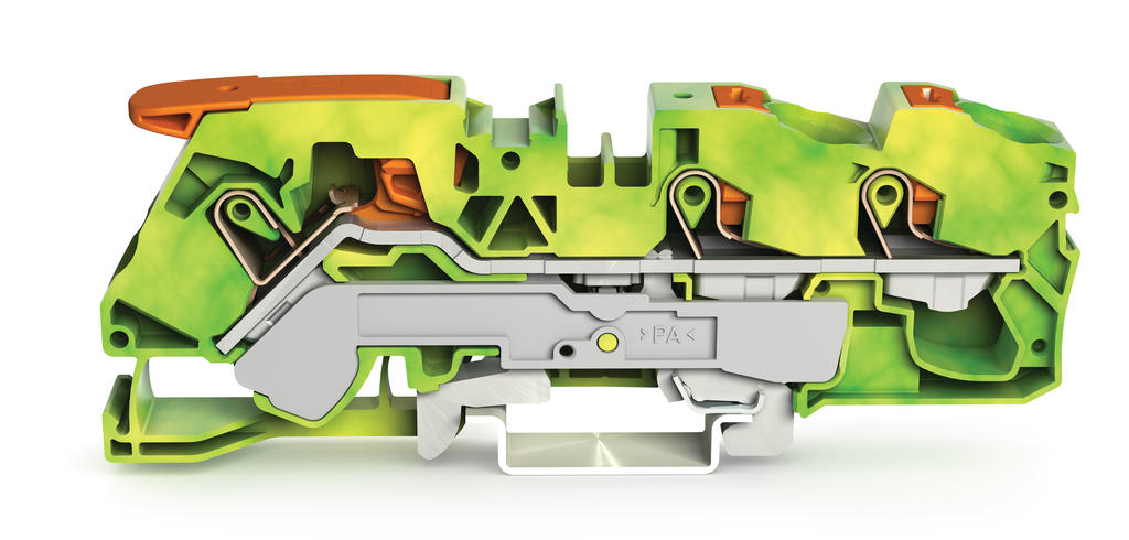

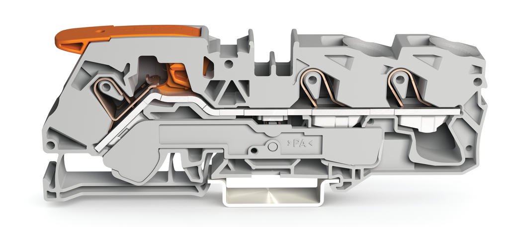

Parameters / Models | 2116-1201![]() | 2116-1204![]() | 2116-1207![]() | 2116-1291![]() | 2116-1292![]() | 2116-1301![]() | 2116-1304![]() | 2116-1307![]() | 2116-1391![]() | 2116-1392![]() | 2116-5201![]() | 2116-5204![]() | 2116-5207![]() | 2116-5301![]() | 2116-5304![]() | 2116-5307![]() |
Actuation type | Lever and Open Tool Slot | Lever and Open Tool Slot | Lever and Open Tool Slot | Lever and Open Tool Slot | Lever and Open Tool Slot | Lever and Open Tool Slot | Lever and Push-button | Lever and Push-button | Lever and Push-button | Lever and Push-button | Lever and Push-button | Lever and Push-button | ||||
Actuation type 2, Push-button | Push-in | Push-in | Push-in | Push-in | Push-in | Push-in | Push-in | Push-in | Push-in | Push-in | Push-in | Push-in | ||||
Цвет | gray | blue | green-yellow | gray | orange | gray | blue | green-yellow | gray | orange | gray | blue | green-yellow | gray | blue | green-yellow |
Connectable conductor materials | Copper | Copper | Copper | Copper | Copper | Copper | Copper | Copper | Copper | Copper | Copper | Copper | ||||
Connection technology | Push-in CAGE CLAMP® | Push-in CAGE CLAMP® | Push-in CAGE CLAMP® | Push-in CAGE CLAMP® | Push-in CAGE CLAMP® | Push-in CAGE CLAMP® | Push-in CAGE CLAMP® | Push-in CAGE CLAMP® | Push-in CAGE CLAMP® | Push-in CAGE CLAMP® | Push-in CAGE CLAMP® | Push-in CAGE CLAMP® | ||||
Country of origin | DE | DE | DE | DE | DE | DE | DE | DE | DE | DE | DE | DE | DE | DE | DE | DE |
Габариты: глубина | 91.5 mm / 3.602 inch | 91.5 mm / 3.602 inch | 91.5 mm / 3.602 inch | 91 mm / 3.583 inch | 91 mm / 3.583 inch | 113.5 mm / 4.469 inch | 113.5 mm / 4.469 inch | 113.5 mm / 4.469 inch | 113.5 mm / 4.469 inch | 113.5 mm / 4.469 inch | 91.5 mm / 3.602 inch | 91.5 mm / 3.602 inch | 91.5 mm / 3.602 inch | 113.5 mm / 4.469 inch | 113.5 mm / 4.469 inch | 113.5 mm / 4.469 inch |
Design | horizontal | horizontal | horizontal | horizontal | horizontal | horizontal | horizontal | horizontal | horizontal | horizontal | horizontal | horizontal | ||||
Fine-stranded conductor | 0.5 … 25 mm² / 20 … 4 AWG | 0.5 … 25 mm² / 20 … 4 AWG | 0.5 … 25 mm² / 20 … 4 AWG | 0.5 … 25 mm² / 20 … 4 AWG | 0.5 … 25 mm² / 20 … 4 AWG | 0.5 … 25 mm² / 20 … 4 AWG | 0.5 … 25 mm² / 20 … 4 AWG | 0.5 … 25 mm² / 20 … 4 AWG | 0.5 … 25 mm² / 20 … 4 AWG | 0.5 … 25 mm² / 20 … 4 AWG | 0.5 … 25 mm² / 20 … 4 AWG | 0.5 … 25 mm² / 20 … 4 AWG | ||||
Fine-stranded conductor with ferrule, push-in termination, from | 2.5 mm² / 14 AWG | 2.5 mm² / 14 AWG | 2.5 mm² / 14 AWG | 2.5 mm² / 14 AWG | 2.5 mm² / 14 AWG | 2.5 mm² / 14 AWG | 2.5 mm² / 14 AWG | 2.5 mm² / 14 AWG | 2.5 mm² / 14 AWG | 2.5 mm² / 14 AWG | 2.5 mm² / 14 AWG | 2.5 mm² / 14 AWG | ||||
GTIN | 4055143754422 | 4055143754439 | 4055143754446 | 4055143747547 | 4055143747554 | 4055143746045 | 4055143746120 | 4055143746137 | 4055143747561 | 4055143747578 | 4055143754507 | 4055143754484 | 4055143754453 | 4055143746144 | 4055143746151 | 4055143746168 |
Height | 36.5 mm / 1.437 inch | 36.5 mm / 1.437 inch | 36.5 mm / 1.437 inch | 36.5 mm / 1.437 inch | ||||||||||||
Height from upper-edge of DIN-35 rail | 36.9 mm / 1.453 inch | 36.9 mm / 1.453 inch | 36.9 mm / 1.453 inch | 36.9 mm / 1.453 inch | 36.9 mm / 1.453 inch | 36.9 mm / 1.453 inch | 37.1 mm / 1.461 inch | 37.1 mm / 1.461 inch | 37.1 mm / 1.461 inch | 37.1 mm / 1.461 inch | 37.1 mm / 1.461 inch | 37.1 mm / 1.461 inch | ||||
Insulating material | Polyamide 66 (PA 66) | Polyamide 66 (PA 66) | Polyamide 66 (PA 66) | Polyamide 66 (PA 66) | Polyamide 66 (PA 66) | Polyamide 66 (PA 66) | Polyamide 66 (PA 66) | Polyamide 66 (PA 66) | Polyamide 66 (PA 66) | Polyamide 66 (PA 66) | Polyamide 66 (PA 66) | Polyamide 66 (PA 66) | ||||
Legend (ratings) | (III / 3) ≙ Overvoltage category III / Pollution degree 3 | (III / 3) ≙ Overvoltage category III / Pollution degree 3 | (III / 3) ≙ Overvoltage category III / Pollution degree 3 | (III / 3) ≙ Overvoltage category III / Pollution degree 3 | (III / 3) ≙ Overvoltage category III / Pollution degree 3 | (III / 3) ≙ Overvoltage category III / Pollution degree 3 | (III / 3) ≙ Overvoltage category III / Pollution degree 3 | (III / 3) ≙ Overvoltage category III / Pollution degree 3 | ||||||||
Marking level | Center/side marking | Center/side marking | Center/side marking | Center/side marking | Center/side marking | Center/side marking | Center/side marking | Center/side marking | Center/side marking | Center/side marking | Center/side marking | Center/side marking | ||||
Nominal cross section | 16 mm² | 16 mm² | 16 mm² | 16 mm² | 16 mm² | 16 mm² | 16 mm² | 16 mm² | 16 mm² | 16 mm² | 16 mm² | 16 mm² | ||||
Number of levels | 1 | 1 | 1 | 1 | 1 | 1 | 1 | 1 | 1 | 1 | 1 | 1 | ||||
Packaging type | BOX | BOX | BOX | BOX | BOX | BOX | BOX | BOX | BOX | BOX | BOX | BOX | BOX | BOX | BOX | BOX |
Rated current, A | 76 | 76 | 76 | 76 | 76 | 76 | 76 | 76 | ||||||||
Rated current (2), A | 90 | 90 | 90 | 90 | 90 | 90 | 90 | 90 | ||||||||
Rated impulse voltage (III / 3), kV | 8 | 8 | 8 | 8 | 8 | 8 | 8 | 8 | ||||||||
Rated voltage (III / 3), В | 800 | 800 | 800 | 800 | 800 | 800 | 800 | 800 | ||||||||
Solid conductor | 0.5 … 16 mm² / 20 … 6 AWG | 0.5 … 16 mm² / 20 … 6 AWG | 0.5 … 16 mm² / 20 … 6 AWG | 0.5 … 16 mm² / 20 … 6 AWG | 0.5 … 16 mm² / 20 … 6 AWG | 0.5 … 16 mm² / 20 … 6 AWG | 0.5 … 16 mm² / 20 … 6 AWG | 0.5 … 16 mm² / 20 … 6 AWG | 0.5 … 16 mm² / 20 … 6 AWG | 0.5 … 16 mm² / 20 … 6 AWG | 0.5 … 16 mm² / 20 … 6 AWG | 0.5 … 16 mm² / 20 … 6 AWG | ||||
Solid conductor, push-in termination | 2.5 … 16 mm² / 14 … 6 AWG | 2.5 … 16 mm² / 14 … 6 AWG | 2.5 … 16 mm² / 14 … 6 AWG | 2.5 … 16 mm² / 14 … 6 AWG | 2.5 … 16 mm² / 14 … 6 AWG | 2.5 … 16 mm² / 14 … 6 AWG | 2.5 … 16 mm² / 14 … 6 AWG | 2.5 … 16 mm² / 14 … 6 AWG | 2.5 … 16 mm² / 14 … 6 AWG | 2.5 … 16 mm² / 14 … 6 AWG | 2.5 … 16 mm² / 14 … 6 AWG | 2.5 … 16 mm² / 14 … 6 AWG | ||||
Strip length | 18 … 20 mm / 0.71 … 0.79 Inch | 18 … 20 mm / 0.71 … 0.79 Inch | 18 … 20 mm / 0.71 … 0.79 Inch | 18 … 20 mm / 0.71 … 0.79 Inch | 18 … 20 mm / 0.71 … 0.79 Inch | 18 … 20 mm / 0.71 … 0.79 Inch | 18 … 20 mm / 0.71 … 0.79 Inch | 18 … 20 mm / 0.71 … 0.79 Inch | 18 … 20 mm / 0.71 … 0.79 Inch | 18 … 20 mm / 0.71 … 0.79 Inch | 18 … 20 mm / 0.71 … 0.79 Inch | 18 … 20 mm / 0.71 … 0.79 Inch | ||||
Total number of connection points | 2 | 2 | 2 | 3 | 3 | 3 | 2 | 2 | 2 | 3 | 3 | 3 | ||||
Total number of potentials | 1 | 1 | 1 | 1 | 1 | 1 | 1 | 1 | 1 | 1 | 1 | 1 | ||||
Type of mounting | DIN-35 rail | DIN-35 rail | DIN-35 rail | DIN-35 rail | DIN-35 rail | DIN-35 rail | DIN-35 rail | DIN-35 rail | DIN-35 rail | DIN-35 rail | DIN-35 rail | DIN-35 rail | ||||
Type of wiring | Front-entry wiring | Front-entry wiring | Front-entry wiring | Front-entry wiring | Front-entry wiring | Front-entry wiring | Front-entry wiring | Front-entry wiring | Front-entry wiring | Front-entry wiring | Front-entry wiring | Front-entry wiring | ||||
Вес, г | 32.1 | 32.2 | 39.781 | 3.25 | 3.25 | 40.303 | 40.303 | 56.183 | 4.09 | 4.09 | 32.35 | 23.999 | 40.159 | 40.979 | 40.979 | 56.859 |
Ширина | 12 mm / 0.472 inch | 12 mm / 0.472 inch | 12 mm / 0.472 inch | 1 mm / 0.039 inch | 1 mm / 0.039 inch | 12 mm / 0.472 inch | 12 mm / 0.472 inch | 12 mm / 0.472 inch | 1 mm / 0.039 inch | 1 mm / 0.039 inch | 12 mm / 0.472 inch | 12 mm / 0.472 inch | 12 mm / 0.472 inch | 12 mm / 0.472 inch | 12 mm / 0.472 inch | 12 mm / 0.472 inch |
