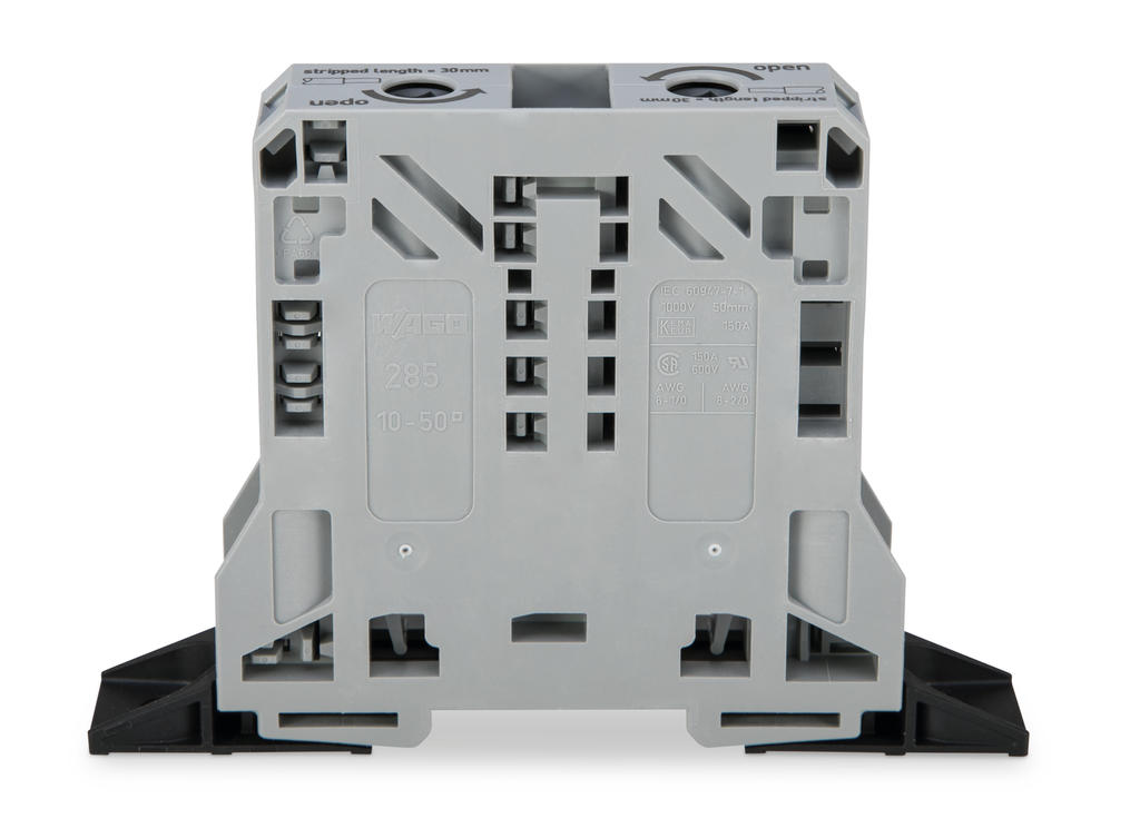

2-проводная сквозная клеммная колодка; 50 мм²; боковые маркерные пазы; с крепежными фланцами; POWER CAGE CLAMP

Actuation type | Operating tool |
Цвет | gray |
Connectable conductor materials | Copper |
Connection technology | POWER CAGE CLAMP |
Country of origin | PL |
Габариты: глубина | 130 mm / 5.118 inch |
Design | horizontal |
Fine-stranded conductor | 10 … 70 mm² / 8 … 2/0 AWG |
GTIN | 4055143608244 |
Height | 94 mm / 3.7 inch |
Height from the surface | 94 mm / 3.7 inch |
Legend (ratings) | (III / 3) ≙ Overvoltage category III / Pollution degree 3 |
Marking level | Side marking |
Mounting type | Mounting flange |
Number of levels | 1 |
Rated current | 150 A |
Rated impulse voltage (III / 3) | 8 kV |
Rated voltage (III / 3) | 1000 В |
Solid conductor | 10 … 50 mm² / 8 … 1/0 AWG |
Strip length | 30 mm / 1.18 Inch |
Total number of connection points | 2 |
Total number of potentials | 1 |
Type of wiring | Side-entry wiring |
Вес | 165.07 г |
Ширина | 20 mm / 0.787 inch |
