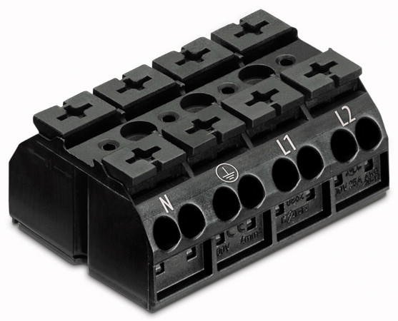

4-проводная клеммная колодка для монтажа на шасси; 1 защелкивающаяся ножка на полюс; N-PE-L1-L2; без заземляющего контакта; 4-полюсная
4-CONDUCTOR CHASSIS-MOUNT TERMIN | |||
| 862-2534 Wago | по запросу | ||
| Actuation type | Operating tool Push-button |
| Цвет | black |
| Connectable conductor materials | Copper |
| Connection technology | Push-in CAGE CLAMP® |
| Country of origin | DE |
| Габариты: глубина | 35 mm / 1.378 inch |
| Fine-stranded conductor | 0.5 … 4 mm² / 20 … 12 AWG |
| Fine-stranded conductor with ferrule with plastic collar | 0.5 … 2.5 mm² / 20 … 12 AWG |
| Fine-stranded conductor with ferrule, push-in termination, from | 0.75 mm² / 18 AWG |
| Fire load | 0.509 MJ |
| GTIN | 4044918510103 |
| Height from the surface | 22.3 mm / 0.878 inch |
| Legend (ratings) | (III / 3) ≙ Overvoltage category III / Pollution degree 3 |
| Marking | N-PE-L1-L2 |
| Mounting type | Snap-in mounting foot |
| Number of Poles | 4 |
| Packaging type | bag |
| Pin spacing | 12 mm / 0.472 inch |
| Product Group | 9 (Std. Chassis Mt. Blocks) |
| Rated current | 32 A |
| Rated impulse voltage (III / 3) | 6 kV |
| Rated voltage (III / 3) | 500 В |
| Solid conductor | 0.5 … 4 mm² / 20 … 12 AWG |
| Solid conductor, push-in termination | 0.75 … 4 mm² / 18 … 12 AWG |
| Stranded conductor | 0.5 … 4 mm² / 20 … 12 AWG |
| Strip length | 10 … 11 mm / 0.39 … 0.43 Inch |
| Total number of connection points | 16 |
| Total number of potentials | 4 |
| Type of mounting | Chassis-mount |
| Type of wiring | Side-entry wiring |
| Вес | 27.99 г |
| Ширина | 48 mm / 1.89 inch |
