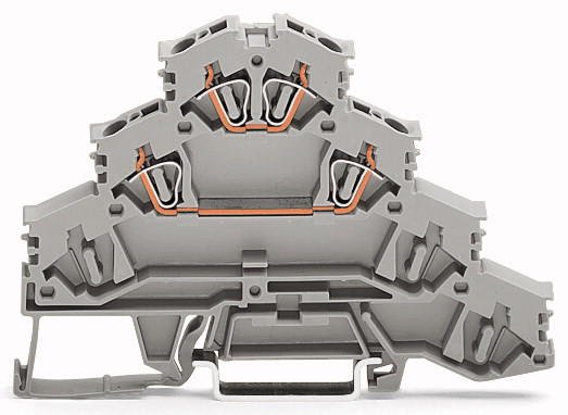

Datasheet Wago 281-531 — Даташит
Четырехъярусная клеммная колодка для монтажа на рейку; Клеммная колодка для монтажа на рейку для электропроводки двигателя; L1 - L2; для DIN-рейки 35 x 15 и 35 x 7,5; 4 мм²; CAGE CLAMP
QUADRUPLE-DECK RAIL-MOUNTED TERM | |||
281-531 Wago | по запросу |
Actuation type | Operating tool |
Цвет | gray |
Connectable conductor materials | Copper |
Connection technology | CAGE CLAMP® |
Country of origin | DE |
Габариты: глубина | 100 mm / 3.937 inch |
Design | angled |
Fine-stranded conductor | 0.08 … 4 mm² / 28 … 12 AWG |
Fire load | 0.38 MJ |
GTIN | 4044918501545 |
Height from upper-edge of DIN-35 rail | 62.5 mm / 2.461 inch |
Legend (ratings) | (III / 3) ≙ Overvoltage category III / Pollution degree 3 |
Marking level | Center/side marking |
Nominal cross section | 2.5 mm² |
Number of levels | 4 |
Potential marking | L1 - L2 |
Product Group | 1 (Rail Mounted Terminal Blocks) |
Rated current | 20 A |
Rated current (2) | 25 A |
Rated impulse voltage (III / 3) | 6 kV |
Rated voltage (III / 3) | 400 В |
Solid conductor | 0.08 … 4 mm² / 28 … 12 AWG |
Strip length | 8 … 9 mm / 0.31 … 0.35 Inch |
Total number of connection points | 4 |
Total number of potentials | 2 |
Type of mounting | DIN-35 rail |
Type of wiring | Front-entry wiring |
Вес | 17.002 г |
Ширина | 6 mm / 0.236 inch |
