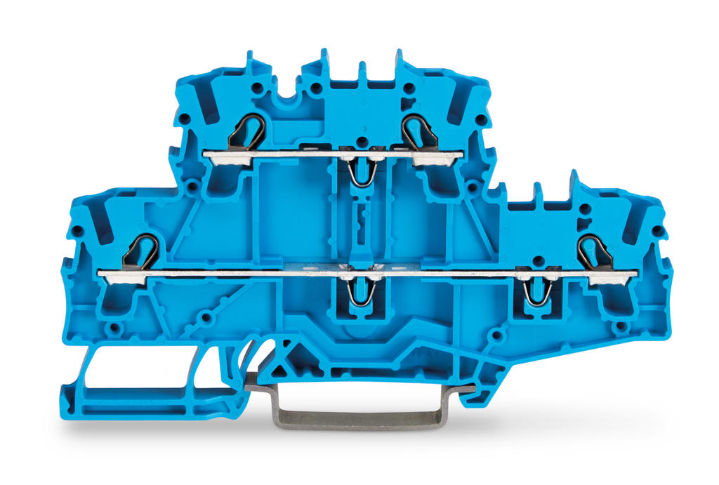

Datasheet Wago 2002-2704 — Даташит
Двухуровневый клеммный блок; Сквозной/сквозной клеммный блок; N/N; без держателя маркера; для применений Ex e II и Ex i; для DIN-рейки 35 x 15 и 35 x 7,5; 2,5 мм²; Push-in CAGE CLAMP
Купить 2002-2704 на РадиоЛоцман.Цены — от 696 до 833 ₽13 предложений от 3 поставщиков Клеммные Колодки на DIN-рейку | |||
| 2002-2704 | от 696 ₽ | ||
| 2002-2704 Wago | от 833 ₽ | ||
| 2002-2704 Wago | по запросу | ||
| Actuation type | Push-in Operating tool |
| Цвет | blue |
| Connectable conductor materials | Copper |
| Connection technology | Push-in CAGE CLAMP® |
| Country of origin | DE |
| Габариты: глубина | 92.5 mm / 3.642 inch |
| Design | horizontal |
| Fine-stranded conductor | 0.25 … 4 mm² / 22 … 12 AWG |
| Fine-stranded conductor with ferrule, push-in termination, from | 0.75 mm² / 18 AWG |
| GTIN | 4055143622530 |
| Height from upper-edge of DIN-35 rail | 51.7 mm / 2.035 inch |
| Insulating material | Polyamide 66 (PA 66) |
| Legend (ratings) | (III / 3) ≙ Overvoltage category III / Pollution degree 3 |
| Marking level | Center/side marking |
| Nominal cross section | 2.5 mm² |
| Number of connection points | 2 |
| Number of connection points (connection type) | 2 |
| Number of levels | 2 |
| Potential marking | N/N |
| Rated current | 24 A |
| Rated current (2) | 28 A |
| Rated impulse voltage (III / 3) | 8 kV |
| Rated voltage (III / 3) | 800 В |
| Solid conductor | 0.25 … 4 mm² / 22 … 12 AWG |
| Solid conductor, push-in termination | 0.75 … 4 mm² / 18 … 12 AWG |
| Strip length | 10 … 12 mm / 0.39 … 0.47 Inch |
| Total number of connection points | 4 |
| Total number of potentials | 2 |
| Type of mounting | DIN-35 rail |
| Type of wiring | Front-entry wiring |
| Вес | 12.532 г |
| Ширина | 5.2 mm / 0.205 inch |
