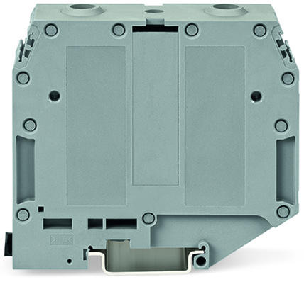

Клеммная колодка винтового типа; 95 мм²; для DIN-рейки 35 x 15 и 35 x 7,5

| Actuation type | Operating tool |
| Цвет | blue |
| Connectable conductor materials | Copper |
| Connection technology | Screw-clamp connection/Studs |
| Country of origin | FR |
| Габариты: глубина | 95 mm / 3.74 inch |
| Design | horizontal |
| GTIN | 4017332186889 |
| Height from upper-edge of DIN-35 rail | 72.5 mm / 2.854 inch |
| Legend (ratings) | (III / 3) ≙ Overvoltage category III / Pollution degree 3 |
| Marking level | Side marking |
| Number of levels | 1 |
| Product Group | 1 (Rail Mounted Terminal Blocks) |
| Rated current | 232 A |
| Rated impulse voltage (III / 3) | 8 kV |
| Rated voltage (III / 3) | 1000 В |
| Solid conductor | 35 … 95 mm² / 2 … 4/0 AWG |
| Strip length | 25 … 27 mm / 0.98 … 1.06 Inch |
| Total number of connection points | 2 |
| Total number of potentials | 1 |
| Type of mounting | DIN-35 rail |
| Type of wiring | Side-entry wiring |
| Вес | 232.1 г |
| Ширина | 26 mm / 1.024 inch |
