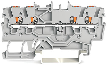

Клеммная колодка TOPJOB S с проходными клеммами и кнопками; монтаж на рейку; 4-проводная; ширина 3,5 мм; серая

Actuation typePush-button
Цветgray
Connectable conductor materialsCopper
Connection technologyPush-in CAGE CLAMP®
Country of originDE
Габариты: глубина67.9 mm / 2.673 inch
Designhorizontal
Fine-stranded conductor0.14 … 1.5 mm² / 24 … 16 AWG
Fine-stranded conductor with ferrule, push-in termination, from0.5 mm² / 20 AWG
GTIN4055143691734
Height from upper-edge of DIN-35 rail32.9 mm / 1.295 inch
Insulating materialPolyamide 66 (PA 66)
Legend (ratings)(III / 3) ≙ Overvoltage category III / Pollution degree 3
Marking levelCenter/side marking
Nominal cross section1 mm²
Number of levels1
Packaging typeBOX
Rated current13.5 A
Rated current (2)18 A
Rated impulse voltage (III / 3)8 kV
Rated voltage (III / 3)800 В
Solid conductor0.14 … 1.5 mm² / 24 … 16 AWG
Solid conductor, push-in termination0.5 … 1.5 mm² / 20 … 16 AWG
Strip length9 … 11 mm / 0.35 … 0.43 Inch
Total number of connection points4
Total number of potentials1
Type of mountingDIN-35 rail
Type of wiringFront-entry wiring
Вес4.888 г
Ширина3.5 mm / 0.138 inch
