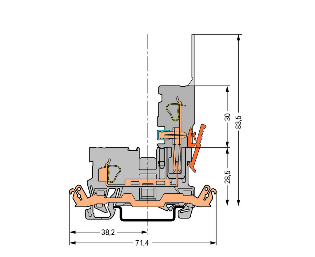

1-проводные / 1-контактные базовые клеммы; с контактом для экрана; для DIN-рейки 35 x 15 и 35 x 7,5; 4 mm²; CAGE CLAMP
| 1-CONDUCTOR/1-PIN CARRIER TERMIN | |||
| 769-231 Wago | по запросу | ||
| Actuation type | Operating tool |
| Цвет | gray |
| Connectable conductor materials | Copper |
| Connection technology | CAGE CLAMP® |
| Country of origin | DE |
| Габариты: глубина | 71.5 mm / 2.815 inch |
| Design | horizontal |
| Fine-stranded conductor | 0.08 … 4 mm² / 28 … 12 AWG |
| Fire load | 0.104 MJ |
| GTIN | 4050821107415 |
| Height from upper-edge of DIN-35 rail | 28.5 mm / 1.122 inch |
| Insulating material | Polyamide 66 (PA 66) |
| Legend (ratings) | (III / 3) ≙ Overvoltage category III / Pollution degree 3 |
| Marking level | Center marking |
| Nominal cross section | 4 mm² |
| Number of levels | 1 |
| Product Group | 18 (X-COM-System) |
| Rated current | 32 A |
| Rated impulse voltage (III / 3) | 4 kV |
| Rated voltage (III / 3) | 250 В |
| Solid conductor | 0.08 … 4 mm² / 28 … 12 AWG |
| Strip length | 8 … 9 mm / 0.31 … 0.35 Inch |
| Total number of connection points | 1 |
| Total number of potentials | 1 |
| Type of mounting | DIN-35 rail |
| Type of wiring | Front-entry wiring |
| Вес | 7.516 г |
| Ширина | 5 mm / 0.197 inch |
