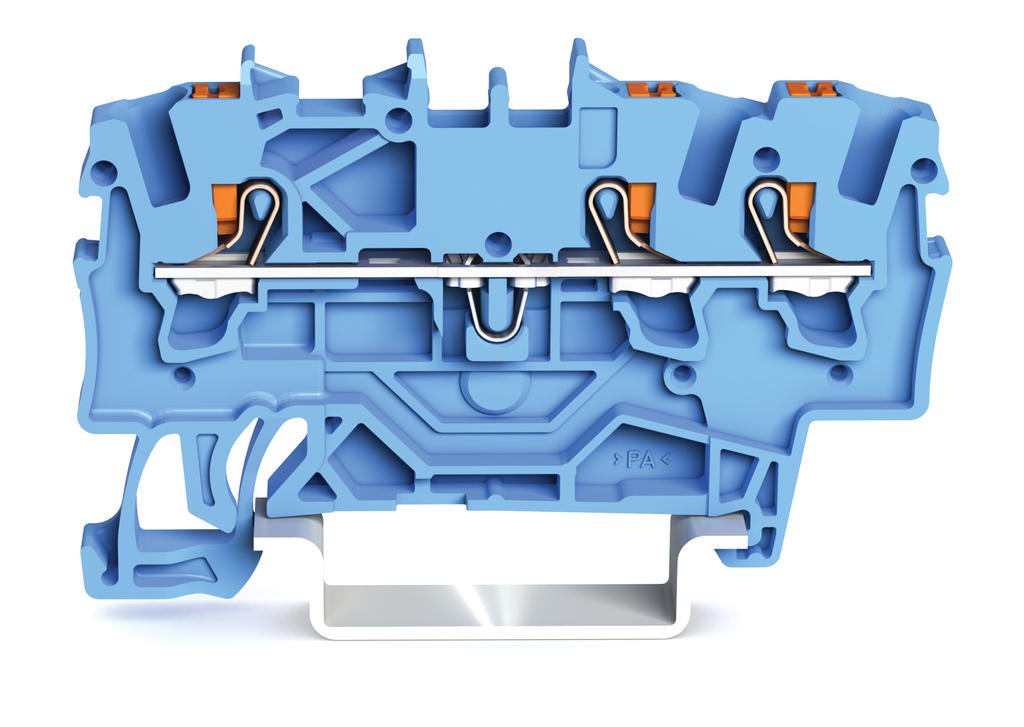

Проходная клеммная колодка TOPJOB S с кнопками; монтаж на рейку; 3-проводная; ширина 4,2 мм; синяя

Actuation typePush-button
Цветblue
Connectable conductor materialsCopper
Connection technologyPush-in CAGE CLAMP®
Country of originDE
Габариты: глубина59.2 mm / 2.33 inch
Designhorizontal
Fine-stranded conductor0.25 … 2.5 mm² / 22 … 14 AWG
Fine-stranded conductor with ferrule, push-in termination, from0.75 mm² / 18 AWG
GTIN4055143696814
Height from upper-edge of DIN-35 rail32.9 mm / 1.295 inch
Insulating materialPolyamide 66 (PA 66)
Legend (ratings)(III / 3) ≙ Overvoltage category III / Pollution degree 3
Marking levelCenter/side marking
Nominal cross section1.5 mm²
Number of levels1
Packaging typeBOX
Rated current18 A
Rated current (2)24 A
Rated impulse voltage (III / 3)8 kV
Rated voltage (III / 3)800 В
Solid conductor0.25 … 2.5 mm² / 22 … 14 AWG
Solid conductor, push-in termination0.75 … 2.5 mm² / 18 … 14 AWG
Strip length9 … 11 mm / 0.35 … 0.43 Inch
Total number of connection points3
Total number of potentials1
Type of mountingDIN-35 rail
Type of wiringFront-entry wiring
Вес5.03 г
Ширина4.2 mm / 0.165 inch
