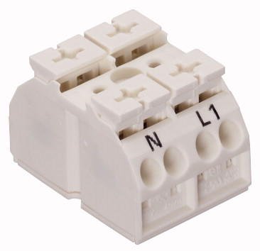

4-проводная клеммная колодка для монтажа на шасси; для самореза 2,9 мм Ø снизу; N-L1; с 2 штифтами; 2-полюсная
4-CONDUCTOR CHASSIS-MOUNT TERMIN | |||
862-2662 Wago | по запросу |
Actuation type | Operating tool Push-button |
Цвет | white |
Connectable conductor materials | Copper |
Connection technology | Push-in CAGE CLAMP® |
Country of origin | DE |
Габариты: глубина | 35 mm / 1.378 inch |
Fine-stranded conductor | 0.5 … 4 mm² / 20 … 12 AWG |
Fine-stranded conductor with ferrule with plastic collar | 0.5 … 2.5 mm² / 20 … 12 AWG |
Fine-stranded conductor with ferrule, push-in termination, from | 0.75 mm² / 18 AWG |
Fire load | 0.267 MJ |
GTIN | 4044918510318 |
Height from the surface | 22.3 mm / 0.878 inch |
Legend (ratings) | (III / 3) ≙ Overvoltage category III / Pollution degree 3 |
Marking | N-L1 |
Mounting type | Screw mounting |
Number of Poles | 2 |
Packaging type | bag |
Pin spacing | 12 mm / 0.472 inch |
Rated current | 32 A |
Rated impulse voltage (III / 3) | 6 kV |
Rated voltage (III / 3) | 500 В |
Solid conductor | 0.5 … 4 mm² / 20 … 12 AWG |
Solid conductor, push-in termination | 0.75 … 4 mm² / 18 … 12 AWG |
Stranded conductor | 0.5 … 4 mm² / 20 … 12 AWG |
Strip length | 10 … 11 mm / 0.39 … 0.43 Inch |
Total number of connection points | 8 |
Total number of potentials | 2 |
Type of mounting | Chassis-mount |
Type of wiring | Side-entry wiring |
Вес | 14.118 г |
Ширина | 24 mm / 0.945 inch |
