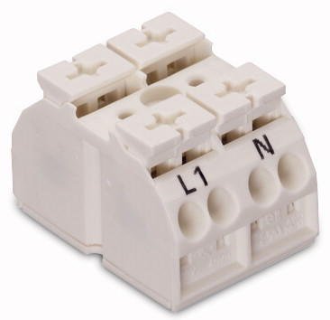

4-проводная клеммная колодка Ex e II для монтажа на шасси; для самонарезающего винта Ø 2,9 мм снизу; L1-N; с 2 штифтами; подходит для применений Ex e II; 2-полюсная
4-CONDUCTOR CHASSIS-MOUNT TERMIN | |||
| 862-1662/999-950 Wago | по запросу | ||
| Actuation type | Operating tool |
| Цвет | white |
| Connectable conductor materials | Copper |
| Connection technology | Push-in CAGE CLAMP® |
| Country of origin | DE |
| Габариты: глубина | 35 mm / 1.378 inch |
| Fine-stranded conductor | 0.5 … 4 mm² / 20 … 12 AWG |
| Fine-stranded conductor with ferrule with plastic collar | 0.5 … 2.5 mm² / 20 … 12 AWG |
| Fine-stranded conductor with ferrule, push-in termination, from | 0.75 mm² / 18 AWG |
| Fire load | 0.267 MJ |
| GTIN | 4045454803520 |
| Height from the surface | 22.3 mm / 0.878 inch |
| Marking | L1-N |
| Mounting type | Screw mounting |
| Number of Poles | 2 |
| Packaging type | bag |
| Pin spacing | 12 mm / 0.472 inch |
| Rated voltage EN (Ex e II) | 440 В |
| Solid conductor | 0.5 … 4 mm² / 20 … 12 AWG |
| Solid conductor, push-in termination | 0.75 … 4 mm² / 18 … 12 AWG |
| Stranded conductor | 0.5 … 4 mm² / 20 … 12 AWG |
| Strip length | 10 … 11 mm / 0.39 … 0.43 Inch |
| Total number of connection points | 8 |
| Total number of potentials | 2 |
| Type of mounting | Chassis-mount |
| Type of wiring | Side-entry wiring |
| Вес | 14.118 г |
| Ширина | 24 mm / 0.945 inch |
