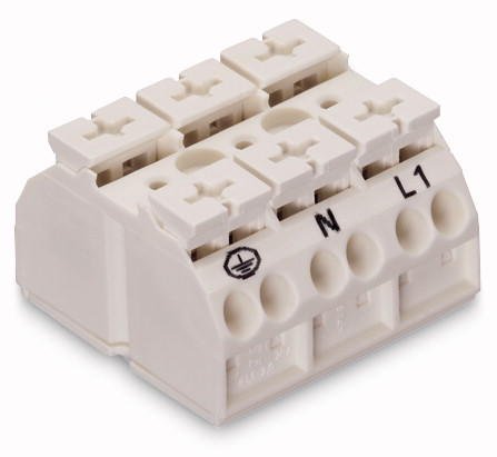

Datasheet Wago 862-1633 — Даташит
ПроизводительWago
Серия862
Модель862-1633
4-проводная клеммная колодка для монтажа на шасси; 1 защелкивающаяся ножка на полюс; PE-N-L1; без заземляющего контакта; 3-полюсная

Actuation typeOperating tool Push-button
Цветwhite
Connectable conductor materialsCopper
Connection technologyPush-in CAGE CLAMP®
Country of originDE
Габариты: глубина35 mm / 1.378 inch
Fine-stranded conductor0.5 … 4 mm² / 20 … 12 AWG
Fine-stranded conductor with ferrule with plastic collar0.5 … 2.5 mm² / 20 … 12 AWG
Fine-stranded conductor with ferrule, push-in termination, from0.75 mm² / 18 AWG
Fire load0.396 MJ
GTIN4044918509732
Height from the surface22.3 mm / 0.878 inch
Legend (ratings)(III / 3) ≙ Overvoltage category III / Pollution degree 3
MarkingPE-N-L1
Mounting typeSnap-in mounting foot
Number of Poles3
Packaging typebag
Pin spacing12 mm / 0.472 inch
Product Group9 (Std. Chassis Mt. Blocks)
Rated current32 A
Rated impulse voltage (III / 3)6 kV
Rated voltage (III / 3)500 В
Solid conductor0.5 … 4 mm² / 20 … 12 AWG
Solid conductor, push-in termination0.75 … 4 mm² / 18 … 12 AWG
Stranded conductor0.5 … 4 mm² / 20 … 12 AWG
Strip length10 … 11 mm / 0.39 … 0.43 Inch
Total number of connection points12
Total number of potentials3
Type of mountingChassis-mount
Type of wiringSide-entry wiring
Вес20.752 г
Ширина36 mm / 1.417 inch
