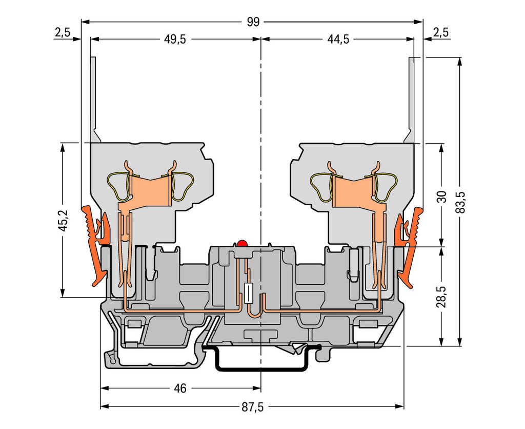

2-контактные базовые клеммы со светодиодом
| 2-PIN COMPONENT CARRIER BLOCK; W | |||
| 769-209/281-413 Wago | по запросу | ||
| Actuation type | Operating tool |
| Цвет | gray |
| Connectable conductor materials | Copper |
| Country of origin | DE |
| Габариты: глубина | 87.5 mm / 3.445 inch |
| Design | horizontal |
| Fire load | 0.159 MJ |
| GTIN | 4050821418405 |
| Height from upper-edge of DIN-35 rail | 28.5 mm / 1.122 inch |
| Insulating material | Polyamide 66 (PA 66) |
| Marking level | Center marking |
| Nominal voltage | 24 В |
| Number of levels | 1 |
| Product Group | 18 (X-COM-System) |
| Total number of potentials | 1 |
| Type of mounting | DIN-35 rail |
| Type of wiring | Front-entry wiring |
| Voltage type (1) | DC |
| Вес | 7.581 г |
| Ширина | 5 mm / 0.197 inch |
