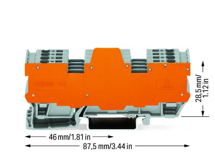

1-проводные / 1-проводные клеммы для сменных модулей; 8-пол.; с 2-проводными клеммами; с 2 позициями для перемычки; с оранжевой разделительной пластиной; для DIN-рейки 35 x 15 и 35 x 7,5; 4 mm²
| 1-CONDUCTOR/1-CONDUCTOR TERMINAL | |||
| 769-194/769-319 Wago | по запросу | ||
| Actuation type | Operating tool |
| Цвет | gray |
| Connectable conductor materials | Copper |
| Connection technology | CAGE CLAMP® |
| Country of origin | DE |
| Габариты: глубина | 87.5 mm / 3.445 inch |
| Design | horizontal |
| Fine-stranded conductor | 0.08 … 4 mm² / 28 … 12 AWG |
| Fire load | 0.736 MJ |
| GTIN | 4044918935272 |
| Height from upper-edge of DIN-35 rail | 28.5 mm / 1.122 inch |
| Insulating material | Polyamide 66 (PA 66) |
| Legend (ratings) | (III / 3) ≙ Overvoltage category III / Pollution degree 3 |
| Marking level | Center marking |
| Nominal cross section | 4 mm² |
| Number of Poles | 8 |
| Number of levels | 1 |
| Product Group | 18 (X-COM-System) |
| Rated current | 16 A |
| Rated impulse voltage (III / 3) | 6 kV |
| Rated voltage (III / 3) | 400 В |
| Solid conductor | 0.08 … 4 mm² / 28 … 12 AWG |
| Strip length | 8 … 9 mm / 0.31 … 0.35 Inch |
| Total number of connection points | 8 |
| Total number of potentials | 8 |
| Type of mounting | DIN-35 rail |
| Type of wiring | Front-entry wiring |
| Вес | 37.49 г |
| Ширина | 21.1 mm / 0.831 inch |
