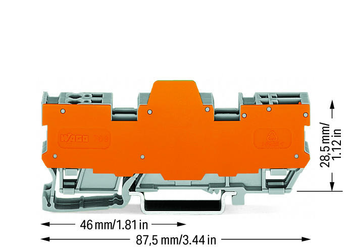

1-проводные / 1-контактные клеммы для сменных модулей; 4-пол.; с 2 позициями для перемычки; с оранжевой разделительной пластиной; для DIN-рейки 35 x 15 и 35 x 7,5; 4 mm²
1-CONDUCTOR/1-PIN TERMINAL BLOCK | |||
769-182/769-314 Wago | по запросу |
Actuation type | Operating tool |
Цвет | gray |
Connectable conductor materials | Copper |
Connection technology | CAGE CLAMP® |
Country of origin | DE |
Габариты: глубина | 87.5 mm / 3.445 inch |
Design | horizontal |
Fine-stranded conductor | 0.08 … 4 mm² / 28 … 12 AWG |
Fire load | 0.404 MJ |
GTIN | 4044918934848 |
Height from upper-edge of DIN-35 rail | 28.5 mm / 1.122 inch |
Legend (ratings) | (III / 3) ≙ Overvoltage category III / Pollution degree 3 |
Marking level | Center marking |
Nominal cross section | 4 mm² |
Number of Poles | 4 |
Number of levels | 1 |
Product Group | 18 (X-COM-System) |
Rated current | 16 A |
Rated impulse voltage (III / 3) | 6 kV |
Rated voltage (III / 3) | 400 В |
Solid conductor | 0.08 … 4 mm² / 28 … 12 AWG |
Strip length | 8 … 9 mm / 0.31 … 0.35 Inch |
Total number of connection points | 2 |
Total number of potentials | 4 |
Type of mounting | DIN-35 rail |
Type of wiring | Front-entry wiring |
Вес | 18.866 г |
Ширина | 11.1 mm / 0.437 inch |
