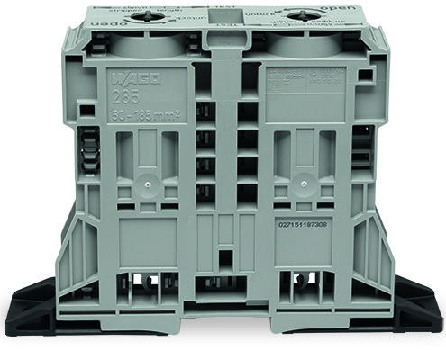

Datasheet Wago 285-1163
2-проводная сквозная клеммная колодка; 185 мм²; подходит для применений Ex e II; боковые маркерные пазы; с крепежными фланцами; POWER CAGE CLAMP
Actuation typeOperating tool
Цветlight gray
Connectable conductor materialsCopper
Connection technologyPOWER CAGE CLAMP
Country of originDE
Габариты: глубина170 mm / 6.693 inch
Designhorizontal
Fine-stranded conductor50 … 185 mm² / 1/0 AWG … 350 kcmil
Fine-stranded conductor with ferrule with plastic collar50 … 150 mm² / 1/0 AWG … 300 kcmil
Fine-stranded conductor with ferrule without plastic collar50 … 185 mm² / 1/0 AWG … 350 kcmil
GTIN4055143753586
Height123 mm / 4.843 inch
Height from the surface123 mm / 4.843 inch
Insulating materialPolyamide 66 (PA 66)
Marking levelSide marking
Mounting typeMounting flange
Nominal cross section185 mm²
Number of levels1
Packaging typeBOX
Rated current (Ex e II)250 A
Rated voltage EN (Ex e II)1000 В
Solid conductor50 … 185 mm² / 1/0 AWG … 350 kcmil
Stranded conductor50 … 185 mm² / 1/0 AWG … 350 kcmil
Strip length45 … 47 mm / 1.77 … 1.85 Inch
Total number of connection points2
Total number of potentials1
Type of wiringSide-entry wiring
Вес565.23 г
Ширина32 mm / 1.26 inch
