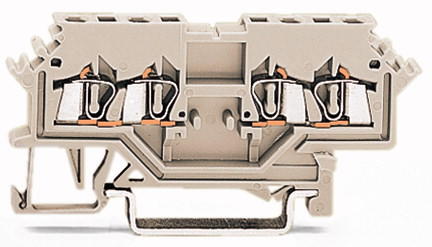

Datasheet Wago 279-989 — Даташит
Клеммная колодка с двойным потенциалом; 1,5 мм²; подходит для применений Ex e II; боковые пазы для маркеров; для DIN-рейки 35 x 15 и 35 x 7,5; CAGE CLAMP
| DOUBLE POTENTIAL TERMINAL BLOCK; | |||
| 279-989 Wago | по запросу | ||
| Actuation type | Operating tool |
| Цвет | light gray |
| Connectable conductor materials | Copper |
| Connection technology | CAGE CLAMP® |
| Country of origin | DE |
| Габариты: глубина | 68 mm / 2.677 inch |
| Design | horizontal |
| Fine-stranded conductor | 0.08 … 1.5 mm² / 28 … 16 AWG |
| Fire load | 0.103 MJ |
| GTIN | 4044918506540 |
| Height from upper-edge of DIN-35 rail | 27 mm / 1.063 inch |
| Insulating material | Polyamide 66 (PA 66) |
| Marking level | Side marking |
| Number of levels | 1 |
| Product Group | 1 (Rail Mounted Terminal Blocks) |
| Rated voltage EN (Ex e II) | 550 В |
| Solid conductor | 0.08 … 1.5 mm² / 28 … 16 AWG |
| Strip length | 8 … 9 mm / 0.31 … 0.35 Inch |
| Total number of connection points | 4 |
| Total number of potentials | 2 |
| Type of mounting | DIN-35 rail |
| Type of wiring | Front-entry wiring |
| Вес | 5.556 г |
| Ширина | 4 mm / 0.157 inch |
