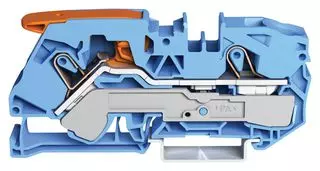

Клеммная колодка TOPJOB S с рычажком и открытым гнездом для инструмента; монтаж на рейку; 2-проводная; ширина 10 мм; синяя

Actuation typeLever and Open Tool Slot
Actuation type 2Push-in Operating tool
Цветblue
Connectable conductor materialsCopper
Connection technologyPush-in CAGE CLAMP®
Country of originDE
Габариты: глубина91.5 mm / 3.602 inch
Designhorizontal
Fine-stranded conductor0.5 … 25 mm² / 20 … 4 AWG
Fine-stranded conductor with ferrule, push-in termination, from2.5 mm² / 14 AWG
GTIN4055143754439
Height from upper-edge of DIN-35 rail36.9 mm / 1.453 inch
Insulating materialPolyamide 66 (PA 66)
Legend (ratings)(III / 3) ≙ Overvoltage category III / Pollution degree 3
Marking levelCenter/side marking
Nominal cross section16 mm²
Number of levels1
Packaging typeBOX
Rated current76 A
Rated current (2)90 A
Rated impulse voltage (III / 3)8 kV
Rated voltage (III / 3)800 В
Solid conductor0.5 … 16 mm² / 20 … 6 AWG
Solid conductor, push-in termination2.5 … 16 mm² / 14 … 6 AWG
Strip length18 … 20 mm / 0.71 … 0.79 Inch
Total number of connection points2
Total number of potentials1
Type of mountingDIN-35 rail
Type of wiringFront-entry wiring
Вес32.2 г
Ширина12 mm / 0.472 inch
