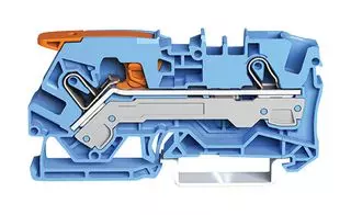

Клеммная колодка TOPJOB S с рычажком и открытым гнездом для инструмента; монтаж на рейку; 2-проводная; ширина 7,5 мм; синяя

Actuation typeLever and Open Tool Slot
Actuation type 2Push-in Operating tool
Цветblue
Connectable conductor materialsCopper
Connection technologyPush-in CAGE CLAMP®
Country of originDE
Габариты: глубина74.8 mm / 2.945 inch
Designhorizontal
Fine-stranded conductor0.5 … 10 mm² / 20 … 8 AWG
Fine-stranded conductor with ferrule, push-in termination, from1.5 mm² / 16 AWG
GTIN4055143742023
Height from upper-edge of DIN-35 rail32.9 mm / 1.295 inch
Insulating materialPolyamide 66 (PA 66)
Legend (ratings)(III / 3) ≙ Overvoltage category III / Pollution degree 3
Marking levelCenter/side marking
Nominal cross section6 mm²
Number of levels1
Packaging typeBOX
Rated current41 A
Rated current (2)57 A
Rated impulse voltage (III / 3)8 kV
Rated voltage (III / 3)800 В
Solid conductor0.5 … 10 mm² / 20 … 8 AWG
Solid conductor, push-in termination1 … 10 mm² / 14 … 8 AWG
Strip length13 … 15 mm / 0.51 … 0.59 Inch
Total number of connection points2
Total number of potentials1
Type of mountingDIN-35 rail
Type of wiringFront-entry wiring
Вес15.077 г
Ширина7.5 mm / 0.295 inch
