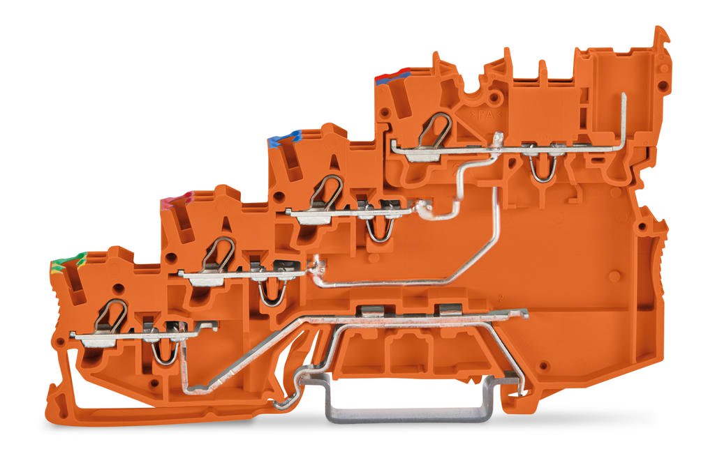

4-проводная клеммная колодка питания датчика; с заземляющим контактом; 1 мм²; Push-in CAGE CLAMP
4-CONDUCTOR SENSOR SUPPLY TERMIN | |||
| 2020-5477 Wago | по запросу | ||
| Actuation type | Open Tool Slot |
| Цвет | orange |
| Connectable conductor materials | Copper |
| Connection technology | Push-in CAGE CLAMP® |
| Country of origin | DE |
| Design | horizontal |
| Fine-stranded conductor | 0.14 … 1.5 mm² / 24 … 16 AWG |
| Fine-stranded conductor with ferrule, push-in termination, from | 0.5 mm² / 20 AWG |
| GTIN | 4055143525510 |
| Height from upper-edge of DIN-35 rail | 52.4 mm / 2.063 inch |
| Insulating material | Polyamide 66 (PA 66) |
| Legend (ratings) | (III / 3) ≙ Overvoltage category III / Pollution degree 3 |
| Marking level | Center marking |
| Nominal cross section | 1 mm² |
| Rated current | 13.5 A |
| Rated voltage (III / 3) | 250 В |
| Solid conductor | 0.14 … 1.5 mm² / 24 … 16 AWG |
| Solid conductor, push-in termination | 0.5 … 1.5 mm² / 20 … 16 AWG |
| Strip length | 9 … 11 mm / 0.35 … 0.43 Inch |
| Total number of connection points | 8 |
| Total number of potentials | 5 |
| Type of mounting | DIN-35 rail |
| Type of wiring | Front-entry wiring |
| Вес | 21.504 г |
| Ширина | 7 mm / 0.276 inch |
