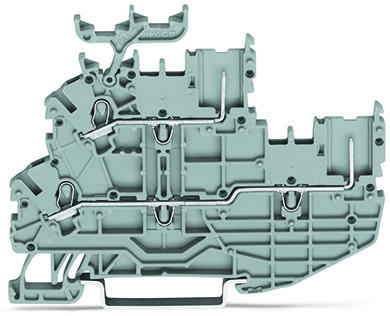

1-проводные / 1-контактные двухуровневые клеммы с розеткой; Проходные / проходные клеммы; N/L; с нанесением маркировки; для DIN-рейки 35 x 15 и 35 x 7,5; Push-in CAGE CLAMP
1-CONDUCTOR/1-PIN DOUBLE DECK RE | |||
2020-2232 Wago | по запросу |
Actuation type | Open Tool Slot |
Цвет | gray |
Connectable conductor materials | Copper |
Connection technology | Push-in CAGE CLAMP® |
Country of origin | CN |
Габариты: глубина | 80.1 mm / 3.154 inch |
Design | horizontal |
Fine-stranded conductor | 0.14 … 1.5 mm² / 24 … 16 AWG |
Fine-stranded conductor with ferrule, push-in termination, from | 0.5 mm² / 20 AWG |
Fire load | 0.198 MJ |
GTIN | 4050821049586 |
Height from upper-edge of DIN-35 rail | 61.4 mm / 2.417 inch |
Legend (ratings) | (III / 3) ≙ Overvoltage category III / Pollution degree 3 |
Marking level | Side marking |
Nominal cross section | 1 mm² |
Number of levels | 2 |
Potential marking | L/L |
Product Group | 18 (X-COM-System) |
Rated current | 13.5 A |
Rated impulse voltage (III / 3) | 6 kV |
Rated voltage (III / 3) | 500 В |
Solid conductor | 0.14 … 1.5 mm² / 24 … 16 AWG |
Solid conductor, push-in termination | 0.5 … 1.5 mm² / 20 … 16 AWG |
Strip length | 9 … 11 mm / 0.35 … 0.43 Inch |
Total number of connection points | 2 |
Total number of potentials | 2 |
Type of mounting | DIN-35 rail |
Type of wiring | Front-entry wiring |
Вес | 8.756 г |
Ширина | 3.5 mm / 0.138 inch |
