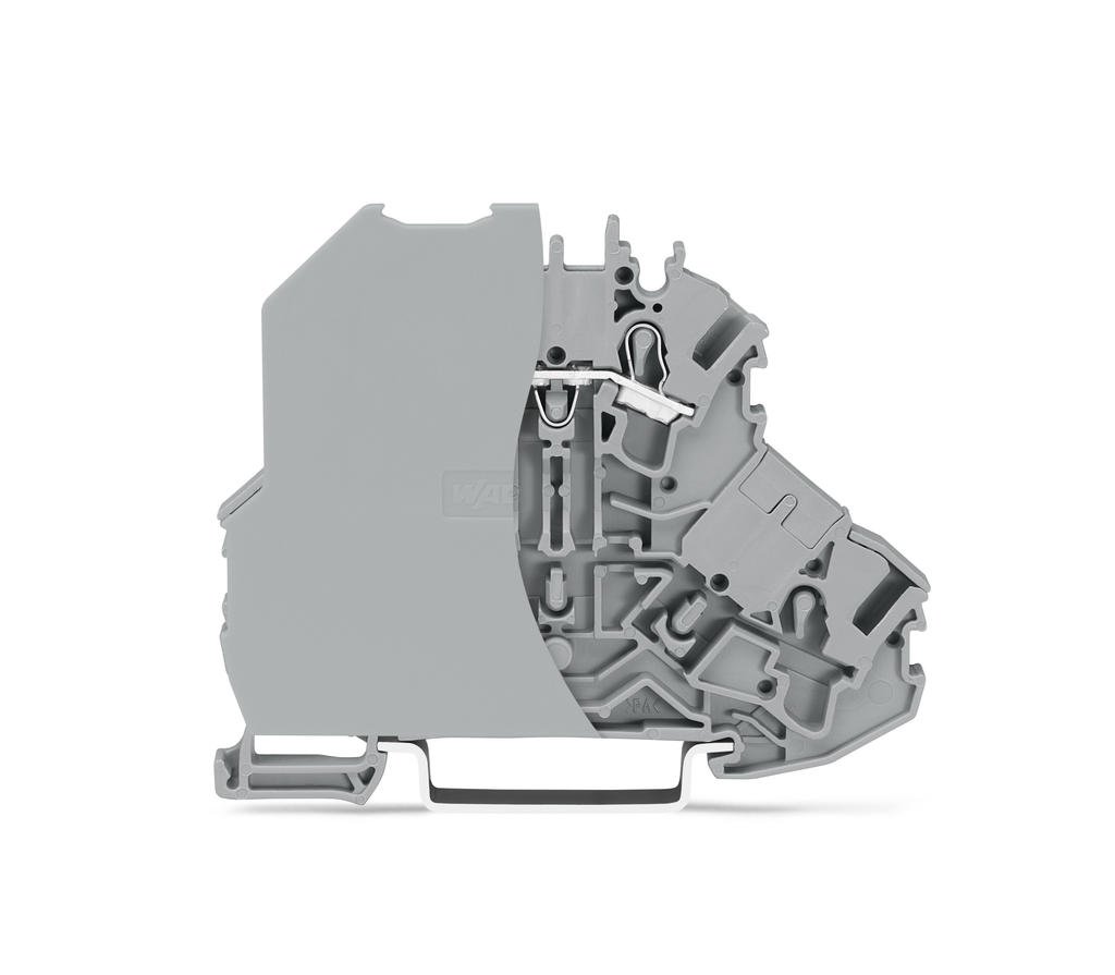

Datasheet Wago 2002-2201/097-000 — Даташит
Двухуровневая клеммная колодка TOPJOB S; проходная только на верхнем уровне; с серым разделителем; монтаж на рейку; 2-проводная; ширина 7,2 мм; серая

Actuation type | Open Tool Slot |
Цвет | gray |
Connectable conductor materials | Copper |
Connection technology | Push-in CAGE CLAMP® |
Country of origin | DE |
Габариты: глубина | 69.9 mm / 2.752 inch |
Design | horizontal |
Fine-stranded conductor | 0.25 … 4 mm² / 22 … 12 AWG |
Fine-stranded conductor with ferrule, push-in termination, from | 0.75 mm² / 18 AWG |
GTIN | 4055143420242 |
Height from upper-edge of DIN-35 rail | 53.3 mm / 2.098 inch |
Marking level | Center/side marking |
Nominal cross section | 2.5 mm² |
Number of levels | 2 |
Potential marking | L |
Solid conductor | 0.25 … 4 mm² / 22 … 12 AWG |
Solid conductor, push-in termination | 0.75 … 4 mm² / 18 … 12 AWG |
Strip length | 10 … 12 mm / 0.39 … 0.47 Inch |
Total number of connection points | 2 |
Total number of potentials | 1 |
Type of mounting | DIN-35 rail |
Type of wiring | Front-entry wiring |
Voltage type (1) | AC/DC |
Вес | 13.25 г |
Ширина | 7.2 mm / 0.283 inch |
