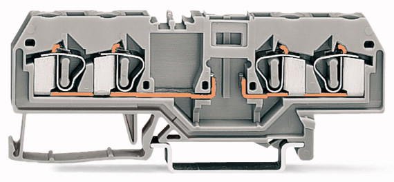

Datasheet Wago 281-656 — Даташит
4-проводная несущая клеммная колодка; для DIN-рейки 35 x 15 и 35 x 7,5; 4 мм²; CAGE CLAMP

| Actuation type | Operating tool |
| Цвет | gray |
| Connectable conductor materials | Copper |
| Connection technology | CAGE CLAMP® |
| Country of origin | CN |
| Габариты: глубина | 86 mm / 3.386 inch |
| Design | horizontal |
| Fine-stranded conductor | 0.08 … 4 mm² / 28 … 12 AWG |
| Fire load | 0.206 MJ |
| GTIN | 4050821214915 |
| Height from upper-edge of DIN-35 rail | 29 mm / 1.142 inch |
| Insulating material | Polyamide 66 (PA 66) |
| Legend (ratings) | (III / 3) ≙ Overvoltage category III / Pollution degree 3 |
| Marking level | Center marking |
| Number of levels | 1 |
| Product Group | 1 (Rail Mounted Terminal Blocks) |
| Rated current | 10 A |
| Rated impulse voltage (III / 3) | 6 kV |
| Rated voltage (III / 3) | 400 В |
| Solid conductor | 0.08 … 4 mm² / 28 … 12 AWG |
| Strip length | 9 … 10 mm / 0.35 … 0.39 Inch |
| Total number of connection points | 4 |
| Total number of potentials | 2 |
| Type of mounting | DIN-35 rail |
| Type of wiring | Front-entry wiring |
| Вес | 12.806 г |
| Ширина | 6 mm / 0.236 inch |
