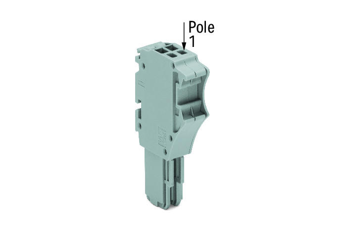

Datasheet Wago 2020-102 — Даташит
1-проводниковая розетка; 1,5; 2-пол.
1-CONDUCTOR FEMALE PLUG; STRAIN | |||
2020-102/142-000 Wago | по запросу | ||
2020-102/122-000 Wago | по запросу | ||
ARW1-2020-102 | по запросу |
Actuation type | Open Tool Slot |
Цвет | gray |
Connectable conductor materials | Copper |
Connection technology | Push-in CAGE CLAMP® |
Connector connection type | for conductors |
Contact type (pluggable connector) | Female connector/socket |
Country of origin | CN |
Габариты: глубина | 22.4 mm / 0.882 inch |
Fine-stranded conductor | 0.14 … 1.5 mm² / 24 … 16 AWG |
Fine-stranded conductor with ferrule, push-in termination, from | 0.5 mm² / 20 AWG |
Fire load | 0.091 MJ |
GTIN | 4050821245025 |
Height | 40.5 mm / 1.594 inch |
Legend (ratings) | (III / 3) ≙ Overvoltage category III / Pollution degree 3 |
Marking level | Side marking |
Nominal cross section | 1 mm² |
Number of Poles | 2 |
Rated current | 13.5 A |
Rated impulse voltage (III / 3) | 6 kV |
Rated voltage (III / 3) | 500 В |
Solid conductor | 0.14 … 1.5 mm² / 24 … 16 AWG |
Solid conductor, push-in termination | 0.5 … 1.5 mm² / 20 … 16 AWG |
Strip length | 9 … 11 mm / 0.35 … 0.43 Inch |
Total number of connection points | 2 |
Total number of potentials | 2 |
Type of wiring | Front-entry wiring |
Вес | 4.91 г |
Ширина | 7.7 mm / 0.303 inch |
