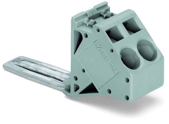

Отвод питания; для сильноточных кабелей сечением 95 мм²

Цвет | gray |
Connection technology | CAGE CLAMP® |
Country of origin | PL |
Design | angled |
Fine-stranded conductor | 0.2 … 10 mm² / 24 … 8 AWG |
Fine-stranded conductor (2) | 0.2 … 16 mm² / 24 … 8 AWG |
Fire load | 0.249 MJ |
GTIN | 4045454326241 |
Marking level | Center marking |
Product Group | 1 (Rail Mounted Terminal Blocks) |
Rated current | 57 A |
Rated impulse voltage (III / 3) | 8 kV |
Rated voltage (III / 3) | 1000 В |
Solid conductor | 0.2 … 10 mm² / 24 … 8 AWG |
Solid conductor (2) | 0.2 … 16 mm² / 24 … 8 AWG |
Strip length | 12 … 13 mm / 0.47 … 0.51 Inch |
Total number of connection points | 2 |
Total number of potentials | 1 |
Type of wiring | Front-entry wiring |
Вес | 22.575 г |
Ширина | 20 mm / 0.787 inch |
