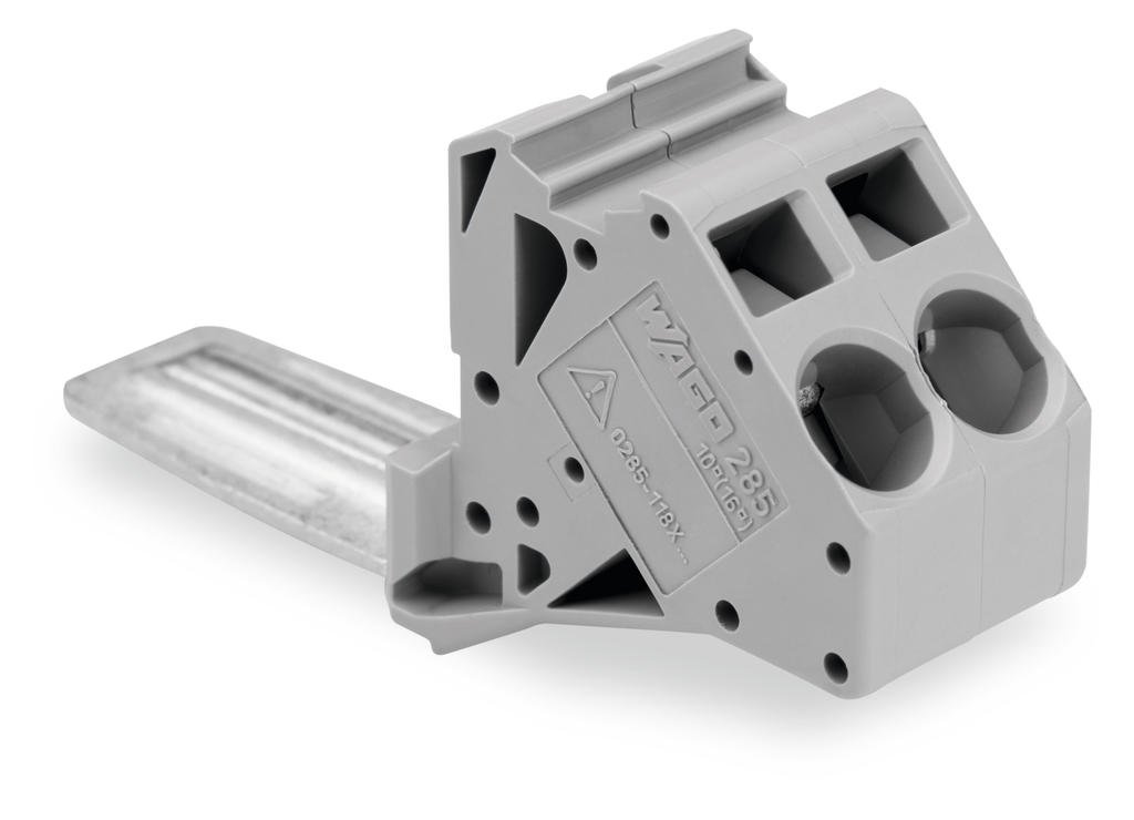

Отвод питания; для клеммных колодок с высоким током 185 мм²

| Connection technology | CAGE CLAMP® |
| Country of origin | DE |
| Design | angled |
| Fine-stranded conductor | 0.2 … 10 mm² / 24 … 8 AWG |
| Fine-stranded conductor (2) | 0.2 … 16 mm² / 24 … 8 AWG |
| GTIN | 4055143354387 |
| Insulating material | Polyamide 66 (PA 66) |
| Marking level | Center marking |
| Packaging type | BOX |
| Rated current | 57 A |
| Rated impulse voltage (III / 3) | 8 kV |
| Rated voltage (III / 3) | 1000 В |
| Solid conductor | 0.2 … 10 mm² / 24 … 8 AWG |
| Solid conductor (2) | 0.2 … 16 mm² / 24 … 8 AWG |
| Strip length | 12 … 13 mm / 0.47 … 0.51 Inch |
| Total number of connection points | 2 |
| Total number of potentials | 1 |
| Type of wiring | Front-entry wiring |
| Вес | 28.13 г |
| Ширина | 20 mm / 0.787 inch |
