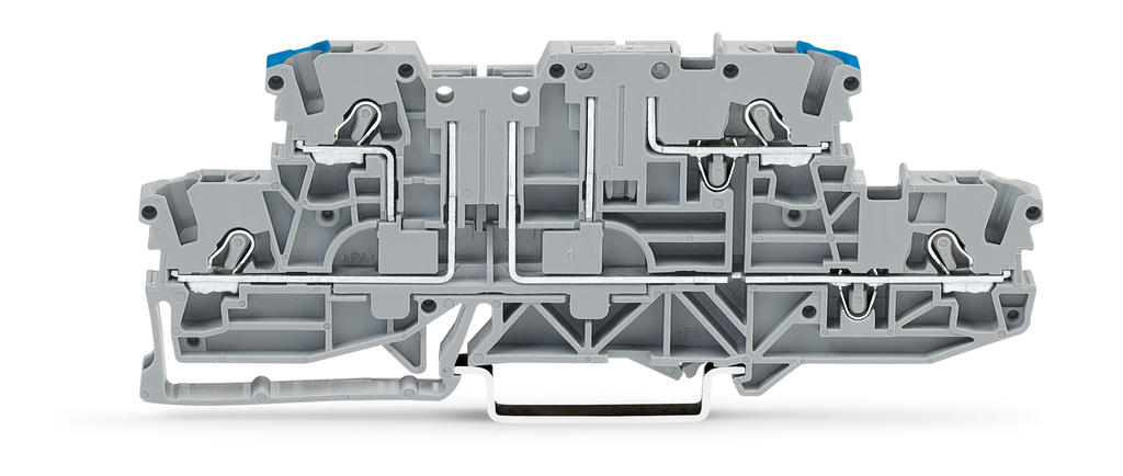

Двухуровневая несущая клеммная колодка; несущая/сквозная (L/N); для разъединения; предохранитель или компонентный штекер; монтаж на рейку; 2-проводная; ширина 5,2 мм; серая
DOUBLE-DECK CARRIER TERMINAL BLO | |||
2002-2963 Wago | по запросу |
Actuation type | Open Tool Slot |
Цвет | gray |
Connectable conductor materials | Copper |
Connection technology | Push-in CAGE CLAMP® |
Country of origin | CN |
Габариты: глубина | 108 mm / 4.252 inch |
Design | horizontal |
Fine-stranded conductor | 0.25 … 4 mm² / 22 … 12 AWG |
Fine-stranded conductor with ferrule, push-in termination, from | 0.75 mm² / 18 AWG |
Fire load | 0.3 MJ |
GTIN | 4050821242413 |
Height from upper-edge of DIN-35 rail | 40.6 mm / 1.598 inch |
Legend (ratings) | (III / 3) ≙ Overvoltage category III / Pollution degree 3 |
Marking level | Side marking |
Nominal cross section | 2.5 mm² |
Number of levels | 2 |
Potential marking | L/N |
Product Group | 22 (TOPJOB S) |
Rated current | 16 A |
Rated impulse voltage (III / 3) | 6 kV |
Rated voltage (III / 3) | 400 В |
Solid conductor | 0.25 … 4 mm² / 22 … 12 AWG |
Solid conductor, push-in termination | 0.75 … 4 mm² / 18 … 12 AWG |
Strip length | 10 … 12 mm / 0.39 … 0.47 Inch |
Total number of connection points | 4 |
Total number of potentials | 5 |
Type of mounting | DIN-35 rail |
Type of wiring | Front-entry wiring |
Вес | 16.68 г |
Ширина | 5.2 mm / 0.205 inch |
