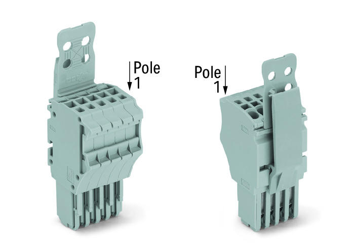

1-проводниковая розетка; Пластина разгрузки натяжения; 1,5; 5-пол.
Augswan
2020-105/143-000
Wago
Wago 2020-105/143-000 Wago 2020-105/143-000
Actuation typeOpen Tool Slot
Цветgray
Connectable conductor materialsCopper
Connection technologyPush-in CAGE CLAMP®
Connector connection typefor conductors
Contact type (pluggable connector)Female connector/socket
Country of originDE
Габариты: глубина27.2 mm / 1.071 inch
Fine-stranded conductor0.14 … 1.5 mm² / 24 … 16 AWG
Fine-stranded conductor with ferrule, push-in termination, from0.5 mm² / 20 AWG
Fire load0.24 MJ
GTIN4050821092568
Height59 mm / 2.323 inch
Insulating materialPolyamide 66 (PA 66)
Legend (ratings)(III / 3) ≙ Overvoltage category III / Pollution degree 3
Marking levelSide marking
Nominal cross section1 mm²
Number of Poles5
Product Group18 (X-COM-System)
Rated current13.5 A
Rated impulse voltage (III / 3)6 kV
Rated voltage (III / 3)500 В
Solid conductor0.14 … 1.5 mm² / 24 … 16 AWG
Solid conductor, push-in termination0.5 … 1.5 mm² / 20 … 16 AWG
Strip length9 … 11 mm / 0.35 … 0.43 Inch
Total number of connection points5
Total number of potentials5
Type of wiringFront-entry wiring
Вес12.645 г
Ширина18.2 mm / 0.717 inch
