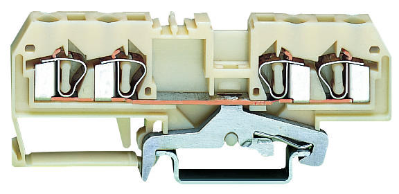

Datasheet Wago 281-658 — Даташит
Клеммная колодка для экрана; 4-проводная; 28-12 AWG; ширина 6 мм
4-CONDUCTOR SHIELD TERMINAL BLOC | |||
281-658 Wago | 2 510 ₽ | ||
281-658 Wago | по запросу |
Actuation type | Operating tool |
Цвет | white |
Connectable conductor materials | Copper |
Connection technology | CAGE CLAMP® |
Country of origin | DE |
Габариты: глубина | 86 mm / 3.386 inch |
Design | horizontal |
Fine-stranded conductor | 0.08 … 4 mm² / 28 … 12 AWG |
Fire load | 0.189 MJ |
GTIN | 4044918512022 |
Height from upper-edge of DIN-35 rail | 29 mm / 1.142 inch |
Marking level | Center marking |
Number of levels | 1 |
Solid conductor | 0.08 … 4 mm² / 28 … 12 AWG |
Strip length | 9 … 10 mm / 0.35 … 0.39 Inch |
Total number of connection points | 4 |
Total number of potentials | 1 |
Type of mounting | DIN-35 rail |
Type of wiring | Front-entry wiring |
Вес | 16.793 г |
Ширина | 6 mm / 0.236 inch |
