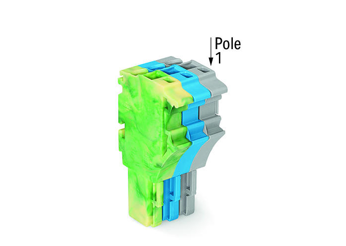

Datasheet Wago 2022-103/000-039 — Даташит
1-проводниковая розетка; 2,5 мм²; 3-пол.
1-CONDUCTOR FEMALE PLUG; 2.5 MM; | |||
2022-103/000-039 Wago | по запросу |
Actuation type | Operating tool Push-in |
Цвет | green-yellow, blue, gray |
Connectable conductor materials | Copper |
Connection technology | Push-in CAGE CLAMP® |
Connector connection type | for conductors |
Contact type (pluggable connector) | Female connector/socket |
Country of origin | DE |
Габариты: глубина | 22.4 mm / 0.882 inch |
Fine-stranded conductor | 0.25 … 4 mm² / 22 … 12 AWG |
Fine-stranded conductor with ferrule, push-in termination, from | 0.75 mm² / 18 AWG |
Fire load | 0.166 MJ |
GTIN | 4045454915766 |
Height | 40.5 mm / 1.594 inch |
Legend (ratings) | (III / 3) ≙ Overvoltage category III / Pollution degree 3 |
Marking level | Side marking |
Nominal cross section | 2.5 mm² |
Number of Poles | 3 |
Product Group | 18 (X-COM-System) |
Rated current | 24 A |
Rated current (2) | 32 A |
Rated impulse voltage (III / 3) | 6 kV |
Rated voltage (III / 3) | 690 В |
Solid conductor | 0.25 … 4 mm² / 22 … 12 AWG |
Solid conductor, push-in termination | 0.75 … 4 mm² / 18 … 12 AWG |
Strip length | 10 … 12 mm / 0.39 … 0.47 Inch |
Total number of connection points | 3 |
Total number of potentials | 3 |
Type of wiring | Front-entry wiring |
Вес | 10.085 г |
Ширина | 15.6 mm / 0.614 inch |
