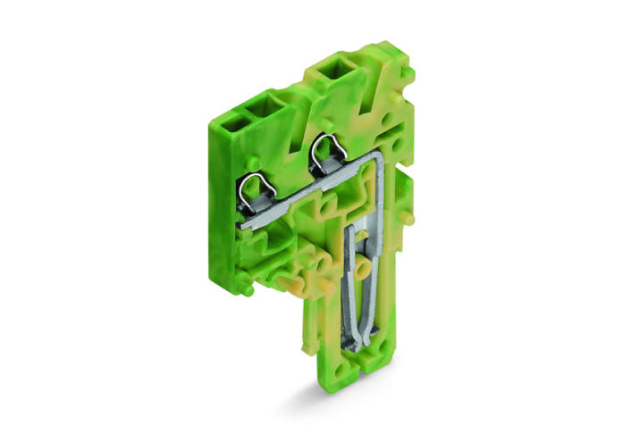

Datasheet Wago 2020-287 — Даташит
Оконечный модуль для 2-проводной розетки; 1,5; 1-пол.
END MODULE FOR 2-CONDUCTOR FEMAL | |||
2020-287 Wago | по запросу |
Actuation type | Open Tool Slot |
Цвет | green-yellow |
Connectable conductor materials | Copper |
Connection technology | Push-in CAGE CLAMP® |
Connector connection type | for conductors |
Contact type (pluggable connector) | Female connector/socket |
Country of origin | DE |
Габариты: глубина | 25 mm / 0.984 inch |
Fine-stranded conductor | 0.14 … 1.5 mm² / 24 … 16 AWG |
Fine-stranded conductor with ferrule, push-in termination, from | 0.5 mm² / 20 AWG |
Fire load | 0.043 MJ |
GTIN | 4050821245285 |
Height | 40.5 mm / 1.594 inch |
Marking level | Side marking |
Nominal cross section | 1 mm² |
Number of Poles | 1 |
Packaging type | BOX |
Product Group | 18 (X-COM-System) |
Rated current UL (Use Group B) | 15 A |
Rated current UL (Use Group C) | 15 A |
Rated current UL (Use Group D) | 15 A |
Rated voltage UL (Use Group B) | 300 В |
Rated voltage UL (Use Group C) | 300 В |
Rated voltage UL (Use Group D) | 300 В |
Solid conductor | 0.14 … 1.5 mm² / 24 … 16 AWG |
Solid conductor, push-in termination | 0.5 … 1.5 mm² / 20 … 16 AWG |
Strip length | 9 … 11 mm / 0.35 … 0.43 Inch |
Total number of connection points | 2 |
Total number of potentials | 1 |
Type of wiring | Front-entry wiring |
Вес | 2.68 г |
Ширина | 3.5 mm / 0.138 inch |
Серия: 2020 (100 из 263)
