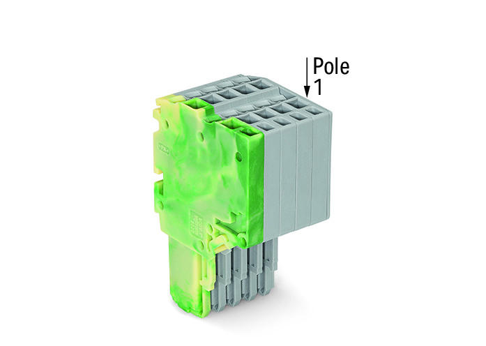

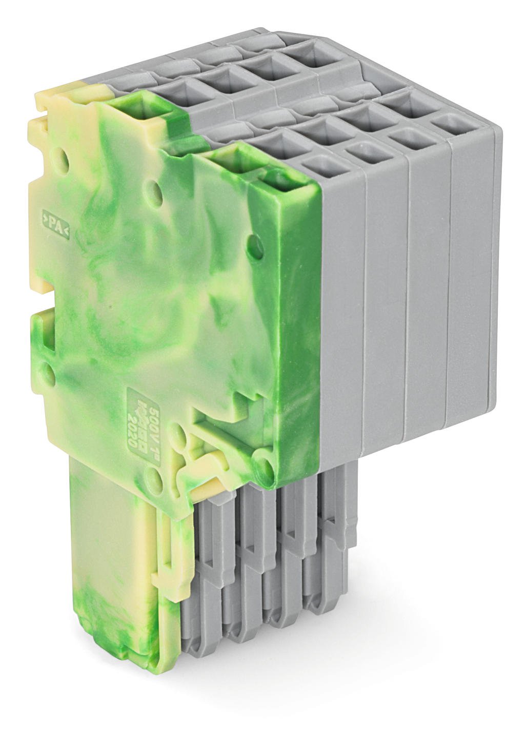

Actuation type | Open Tool Slot |
Цвет | green-yellow, gray |
Connectable conductor materials | Copper |
Connection technology | Push-in CAGE CLAMP® |
Connector connection type | for conductors |
Contact type (pluggable connector) | Female connector/socket |
Country of origin | DE |
Габариты: глубина | 25 mm / 0.984 inch |
Fine-stranded conductor | 0.14 … 1.5 mm² / 24 … 16 AWG |
Fine-stranded conductor with ferrule, push-in termination, from | 0.5 mm² / 20 AWG |
Fire load | 0.235 MJ |
GTIN | 4050821091431 |
Height | 40.5 mm / 1.594 inch |
Legend (ratings) | (III / 3) ≙ Overvoltage category III / Pollution degree 3 |
Marking level | Side marking |
Nominal cross section | 1 mm² |
Number of Poles | 5 |
Product Group | 18 (X-COM-System) |
Rated current | 13.5 A |
Rated impulse voltage (III / 3) | 6 kV |
Rated voltage (III / 3) | 500 В |
Solid conductor | 0.14 … 1.5 mm² / 24 … 16 AWG |
Solid conductor, push-in termination | 0.5 … 1.5 mm² / 20 … 16 AWG |
Strip length | 9 … 11 mm / 0.35 … 0.43 Inch |
Total number of connection points | 10 |
Total number of potentials | 5 |
Type of wiring | Front-entry wiring |
Вес | 14.06 г |
Ширина | 18.2 mm / 0.717 inch |
